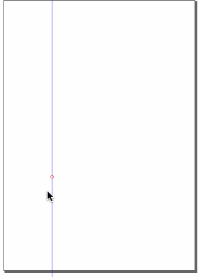

- Sun Oct 27, 2019 10:05 pm
- Topic: ruler repositioning
- Replies: 4
Re: ruler repositioning
Move the cursor slowly to the guide till the cursor turns into a hand shape - then double-click to open its properties and adjust accordingly.

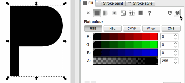

Re: Objects disappear after boolean operation -- weird path?
Why not clip-it-away with the rectangle:
- Thu Oct 24, 2019 6:25 am
- Topic: Corner to curve
- Replies: 18
Re: Corner to curve
That is what I have written.
In the posted link: https://superuser.com/questions/640954/ ... -of-shapes
it´s quoted that it was in the 0.91 dev cycle. So it never made in an official release? It´s so useful for technical stuff.

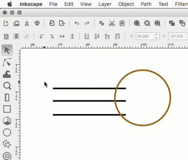

- Topic: Trim using Inkscape
- Replies: 12
Re: Trim using Inkscape
meetdilip wrote:... As you can see from my first image of Inkscape canvas, can I trim the 3 lines with that circle ? I tried but I couldn't make it work.
Maybe Cut Path is what you´re looking for; needs 2 path objects though.
