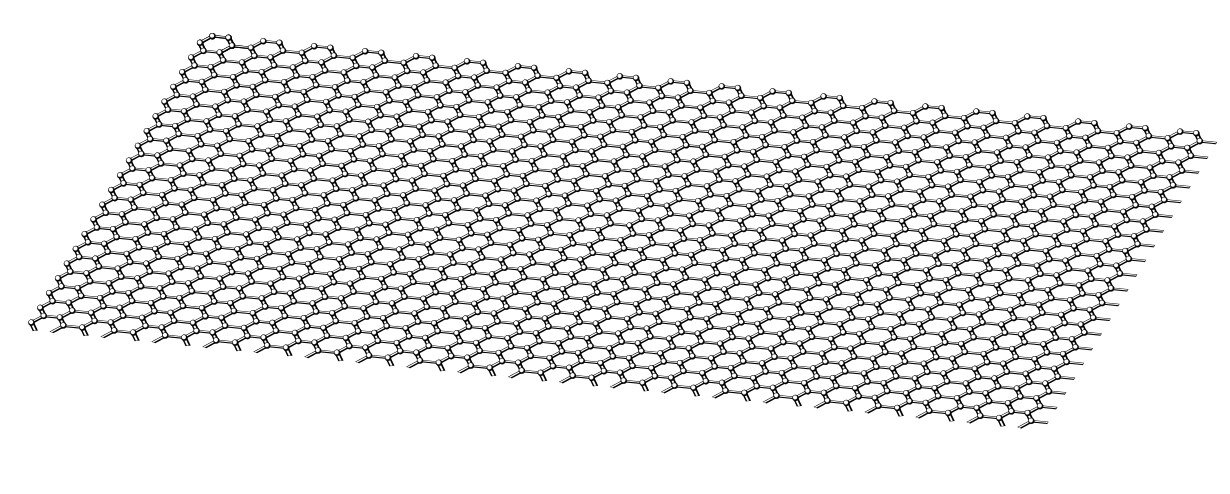

Re: How to create a network with perspective?
You can fake the network by clever use of the tiled clones tool:
but getting the wave is problematic, as the proportions of each hex change depending on the "angle".
-Rob A>

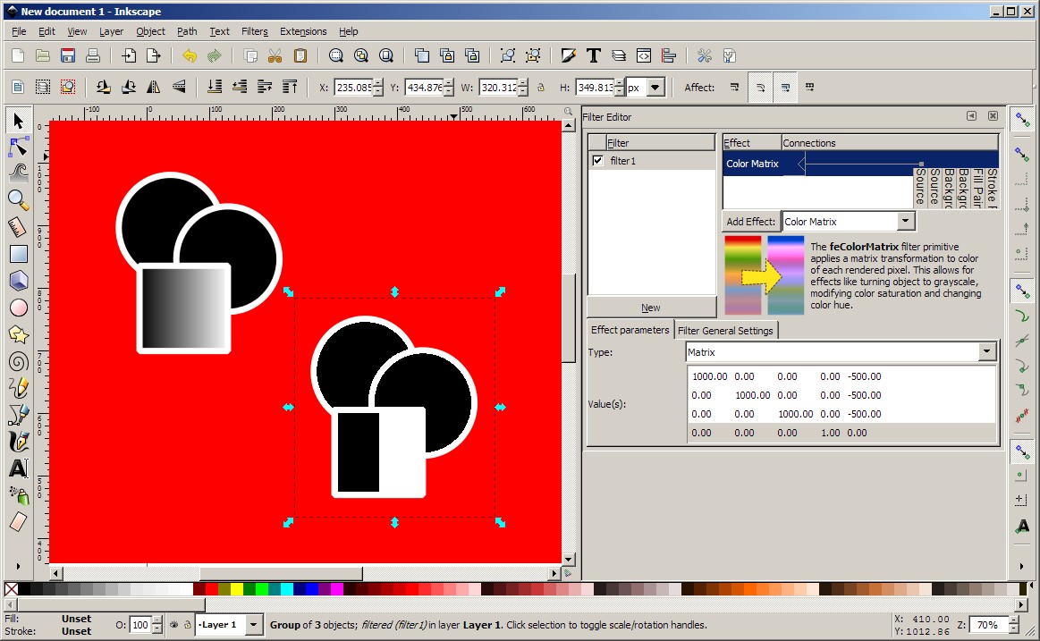

Re: Exported checkered image comes out all blury...
aiat_gamer wrote:Oh, ok I need to change then. One more question, is there and option to work in only black and white environment without any gray scale?
You can group everything and apply a simple filter to make a (kind-of) threshold:
-Rob A>
