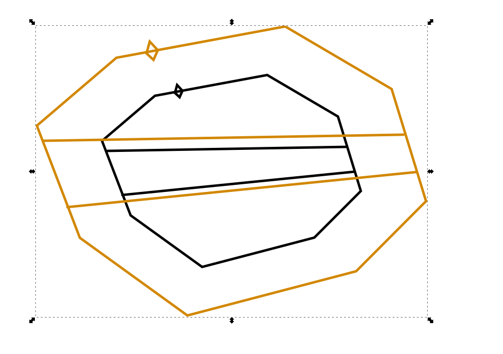

- Sat Jan 28, 2017 10:11 am
- Topic: Outset path - mappig of markings on path?
- Replies: 15
Re: Outset path - mappig of markings on path?
I probably don't correctly understand the question. Seems like if you just put the outline and all the "markers" in a group, duplicate (Ctrl-D), resize (e.g., with Ctrl-Shift), the result would have all the markers in the exactly proportional spot.
