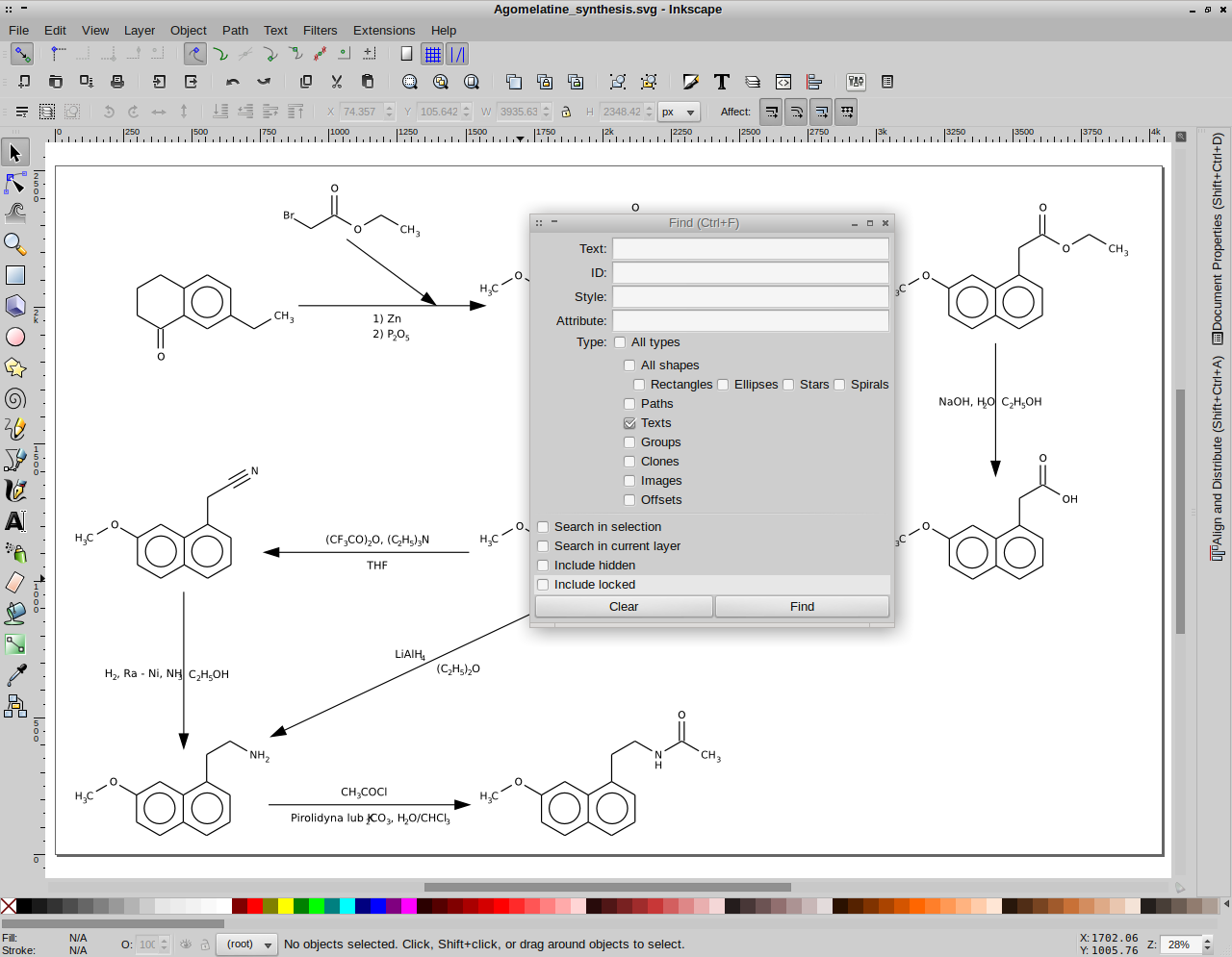

Re: How do I select text only?
You put me on the right track. See picture. This does the trick:
Thank you for your answers, tylerdurden
I need to select all the text in a svg-file and because it is a large text, it is undoable to do that by selecting them one at a time.
My question: how do I select the text and only the text in a large file. I want to do a Stroke to path on these text-files.
