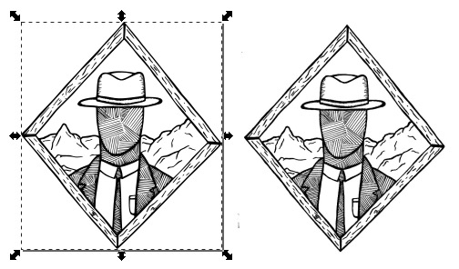

I would scan the artwork at very high resolution before running the trace bitmap.
While the conversion won't necessarily capture the variation in line density, vector conversion could still be very helpful for output to merch where the density would be likely lost.
There are settings in the trace bitmap dialog to remove the background, and the scans can also be split up. The trace bitmap dialog will not remove the original image, which can be deleted or hidden after tracing.
Re: Do I need to vectorize?
After doing some level correction about the first image to get rid of the greyness the default autotrace settings doing a pretty well job:

Polygon, the result you achieved was what I was achieving, but I'm looking to create something which is more natural to the original, but just 'solidifying' my lines, if you like. Thanks for playing around with it.

I might use a higher rez scanner.
You don't need to use vector for merch, but vector does offer the scalability that bitmaps don't.
