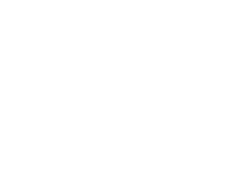

Hi Brynn,
I am using Inkscape 0.48.0 (r9654) on a Vista 32-bit and I know someone has achieved the same results on a Windows 7 machine (32-bit?) and an older inkscape (not sure which one though).
I uploaded the .svg and the resulting .png bitmap of the selection.
The only thing I did was this:
- import a jpeg image (in this case one of the windows sample images
- make a rectangle and set the stroke width to zero
- position the rectangle on the image, select both and Clip->Set
- Export Bitmap, where I only exported the selection
And it seems a bit more finicky than I first mentioned. I did a bit more testing all with stroke width set to 0.00 and got the following results:
- Export Selection - PNG BLANK
- Export page where page is much bigger than clipped image - PNG WORKED
- Resize page to drawing and export page - PNG BLANK
P.S. The reason i was clipping with zero width is because I wanted an image with a specific pixel dimensions. If I clip with a rectangle with stroke thickness the resulting image is slightly smaller. I could always resize after but I thought the zero stroke would have been easier.

- Exported only the clipped image as selection
- clip_export_selection.png (1004 Bytes) Viewed 8585 times

Use 'None' for the stroke (i.e. remove the stroke) and give the rectangle a fill color with reduced alpha transparency so you can position it better (choose what portion of the photo you want to be visible) - instead of setting its width to zero.rtfanson wrote:P.S. The reason i was clipping with zero width is because I wanted an image with a specific pixel dimensions. If I clip with a rectangle with stroke thickness the resulting image is slightly smaller.
I'm not sure why it fails with "stroke-width:0" (reproduced with your drawing and a current development snapshot on Mac OS X 10.5.8) - as soon as I either remove all style information of the clip-path (via XML Editor) or clip the photo with a filled rectangle with no stroke ('None' in the style indicator in the lower left corner of the main window), export works as expected (for selection, drawing, page).
Somehow the exporter seems to decide that for a rectangle with no fill, and a black stroke with zero width, nothing's there to be exported... !?
