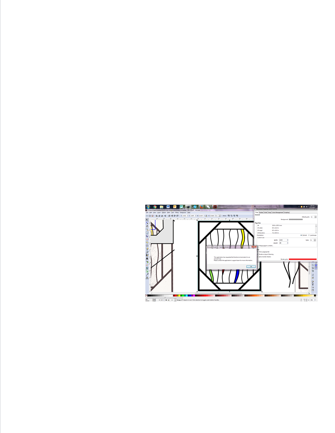

I got the attached error msg 4 times in a couple of hours. Is there something I'm doing to cause this? If not, can I do anything to prevent it?
The attachment is small as Inkscape kept telling me it was too large when I tried to load it bigger. It is a screen shot of the full page I was working on. Please LMK if it's too small to read.
It says:
This application has requested the Runtime to terminate it in an unusual way.
Please contact the application's support team for more information.
TIA
It says:
TIA
- inkscape error msg.png (242.57 KiB) Viewed 2658 times

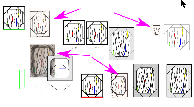

The embedded bitmaps were quite big, from a file size standpoint.
If you can work from this point without the embedded bitmaps, that might help.
Here's a copy with the bitmaps removed.
- clears w- border - 18 X 19.pdf.2017_02_12_15_16_24-nobitmaps.svg
- (102.86 KiB) Downloaded 263 times
Re: Inkscape error msg, freezing & shutting down
The file looks the same to me. Can you please explain "removed bitmaps"? I don't know what this means.
There were imported images, maybe scans or pictures of sketches. These imported images were large from a data/memory standpoint.
If they are no longer needed to advance the project, they can be removed from the document so Inkscape uses less memory and hopefully works better for you.
The file size went from 40MB to about 100kb... 1/400th the size.

Most of the time, that error message happens because your file is larger than Inkscape can handle, given your system's resources, primarily RAM. It sounds like td and others have helped you to chop it down to size.
Here are some tips for working with a large file, to help avoid the crashes:
Tips to Avoid Performance Issues
That error message can also happen with other kinds of problems. But there's really no way (for most users) to know exactly what "unusal way" means. But we do know that most of the time, it's because of not having enough RAM on your computer, to handle the large file.
