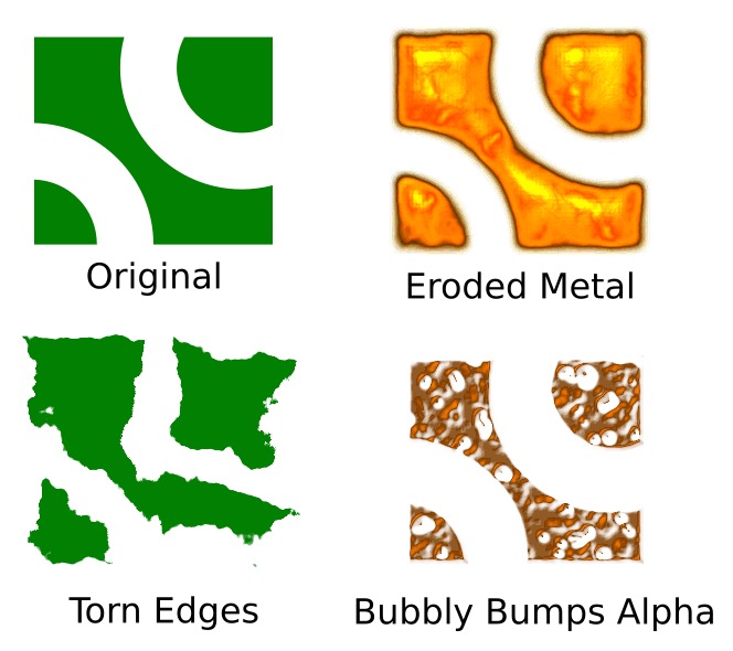

There´are a few filters onboard waiting for you to tweak:
...but the filter UI is not made for me - unfortunately.
