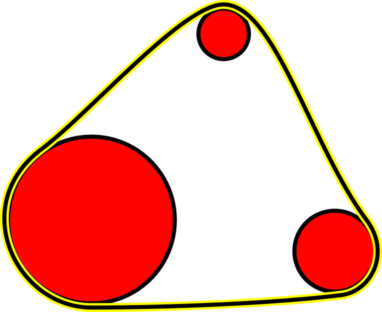

I sometimes draw physics figures. When I have multiple wheel and a belt going around in any direcction, i use some time to adjust the path to align into the wheels until I'm satisfied.
But I ask for a more creative solution. I assume adjustment always will be needed, but is there a smarter way to achieve a near perfect alignment of the belt on the wheels with less work?
- Belt.svg
- a common belt around three wheels - example
- (5.71 KiB) Downloaded 300 times

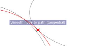

Things have become quite a bit easier, as demonstrated in this movie http://www.diedenrezi.nl/SnapTangentially.webm. As of revision 10866 (see http://bazaar.launchpad.net/~inkscape.dev/inkscape/trunk/revision/10886), Inkscape now tries to snap to paths both tangentially and perpendicularly... but only if "snap to paths" has been enabled, and it cannot be toggled on/off yet.
Please realize that if you try to snap two opposite ends of a single line tangentially, then only one can be truly tangential at any time. That is because if you snap the first end tangentially and subsequently move the second end then the first end will have lost it tangentiallity. This will likely not be a big problem though as it will converge quickly if you iterate a few times over the opposite ends (have a close look at the movie to notice this). This will be fixed in future revisions by enabling tangential and perpendicular snapping in the selector tool, such that one can rotate a line and still have it snap tangentially.

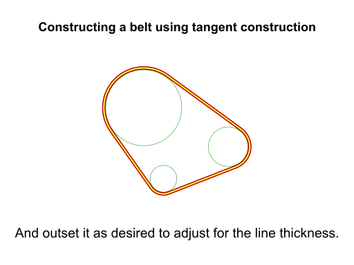

Since this topic is still active I thought I'd put in my ten cents....

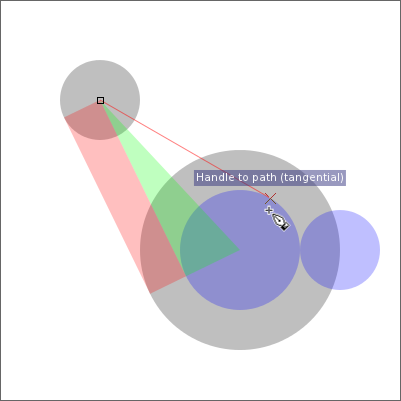

With a recent development version, here's a schema how to create a tangent between two circles
(once the line from the midpoint of the smaller circle to the tangent snap-target on the auxiliary circle has been drawn, the rest is easily constructed by duplicating and moving the line segments - if preferred, with help of guides. The radius of the auxiliary circle = radius of larger circle - radius of smaller circle)
Attaching another sample file (the belt itself is drawn making use of the spiro path effect for the arcs - a 3-node spiro spline sub-path with a smooth node in the middle draws an arc through 3 points):
- tangential-and-perpendicular-snapping-3.svg
- (11.68 KiB) Downloaded 356 times

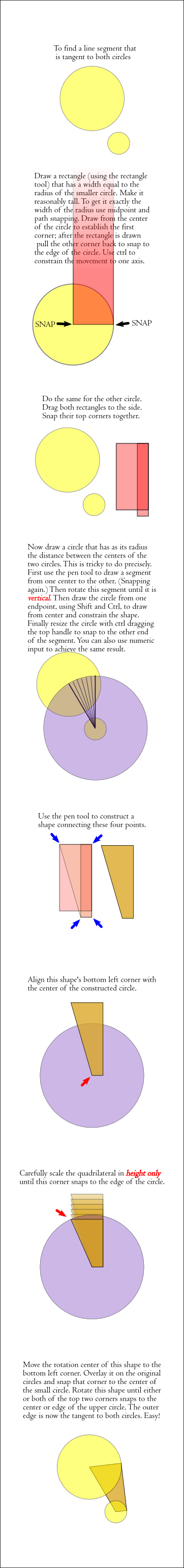

How to construct the auxiliary circle:
- duplicate smaller circle
- move the duplicated circle and let its midpoint snap to the right quadrant point of the larger circle
- drop a vertical guide snapped to the left quadrant point of the duplicated&moved circle
- create the auxiliary circle by first snapping to the midpoint of the larger circle (for the center), and then - while dragging diagonally downwards with 'Shift' and 'Ctrl' pressed - snapping to the guide just placed (for the radius)

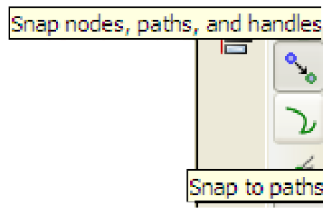

I can now do this in the latest build
But with snapping enabled (top button) and ONLY these two options chosen
I get no snaps... in other words, no "path to path (tangential)"

I think this functionality is already in Inkscape.
Take for example a set of french curves. You can design the exact size and shape of these that you like and put them to the side of your canvas, and then save the file as default. Every time you open a new document these tools will be there. Drag them onto your page to use them.
As far as tracing the edge of a curve or a shape, it's much easier to duplicate the curve, insert a node where you want to begin, another where you want to end, and trim to those nodes. Much quicker than actually following the curve with your pointer. Learnig to use
shortcuts makes it much more useful, joining curves, breaking curves, inverting selection (shortcut: !) and deleting, etc.
You can even put your guide objects in a separate layer and then lock that layer, making it so that you can snap to all your guides, but can't move them or accidentally change their shape.
Also, the measuring tool doesn't get a lot of publicity, but is amazingly versatile, a ruler and protractor in one, measuring without actually having to position it precisely, it snaps to nodes, it can be constrained with ctrl, it ignores locked objects in a smart way, a single pass takes multiple measurements ...
It does not yet tell you when a measuring line is perpendicular or tangential in the way that other drawing tools have just started doing, but i imagine that will be coming soon.
(Bonus: The measure tool's control bar is the only place that I have found where you can change the font size used for all the snap annotations!)
Not trying to disparage your request, but I'm just pointing out that Inkscape is capable of very fine drafting work.
shortcuts makes it much more useful, joining curves, breaking curves, inverting selection (shortcut: !) and deleting, etc. You can even put your guide objects in a separate layer and then lock that layer, making it so that you can snap to all your guides, but can't move them or accidentally change their shape.
