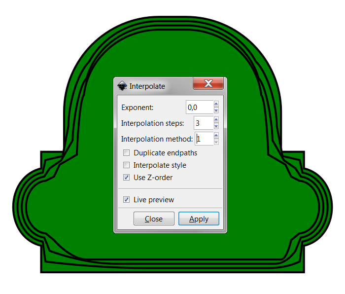

Im trying to make a logo similar in style to this:
https://www.shutterstock.com/de/image-v ... -258161909
I have grown the basic shape. Now i want the intermediate paths for the dotted lines decoration.
When i try to do this with an interpolation, its all garbled up. At first i thought it was because of the different numbers of nodes, but even after adding some to make it even, it doesnt work.

Re: Interpolation Problem
Make sure you create the first shape from the second, then the nodes will (hopefully) be in the correct positions. There needs to be a direct node-to-node correllation between the two shapes.
But anyway, probably the same object copied with different stroke widths or with outsets should give you a better result more quickly.

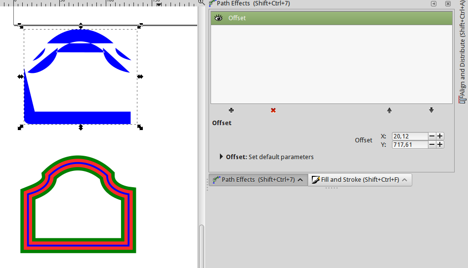

Moini wrote:But anyway, probably the same object copied with different stroke widths
This is what i did, but its a lot of unintuitive math and the dashes behave weirdly in a non functional way, so no dotted decorational lines.
We'll have to wait for Jabier's Dashes LPE for that....
Wasnt there supposed to be a stroke offset LPE as well in the next version of Inkscape ?
Re: Interpolation Problem (Offset Path)
There's an 'offset' LPE in the master version I have, but it doesn't work with sharp corners or straight lines...
Top: offset LPE
Bottom: just using different stroke widths
Top: offset LPE
- Bildschirmfoto_2017-11-17_23-19-46.png (50.77 KiB) Viewed 1128 times
(you can do stroke to path, and apply dashes to result)
