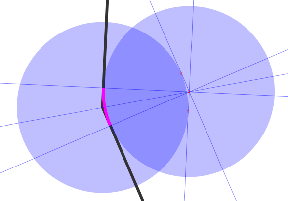

Grobe wrote: In this case, the path is already here and I have to change a corner node into two smooth nodes. The nodes and the node handles must be placed so the path forms into a rounded corner.
Rule to take acount for: The path that isn't part of any round corner is not allowed to move!
Attached file was done with current trunk using tangential (to the circle) and perpendicular (to the line segments) snapping for the positioning of the guides. I'll post detailed steps later [1].
For the path forming the rounded corner I used a spiro spline with three nodes (with 3 nodes, this AFAIU always produces an arc) - the end nodes are snapped to intersections of guides with the original path, and the middle one to the intersection of guide and circle. I prefer this to path operations because you get nicer positioned nodes for the arc after converting the spiro spline effect to path.
The original path can either be node-edited (break at original sharp corner, snap end nodes to new position), or cut/divided/differenced with whatever combination of path operations you prefer (possibly with help of an auxiliary shape drawn on top, based on the guides).
[1] Quick summary:
- convert path to guides (duplicate first unless you have changed the pref)
- move each guide and position it tangential to the circle (which itself is snapped with its center to the cusp corner node)
--> the intersection of the two tangential guides gives you the center of the arc for the rounded corner - create three additional guides, with the origin at the intersection of the two first guides:
- two are rotated and snapped perpendicular to each of the line segments of the original path
- one is rotated and snapped to the cusp corner node of the original path (angle bisector) - (duplicate and) move the circle (snap its center to the guides intersection)
- zoom in closer and use the pen tool with 'Spiro splines' mode to draw the three-node path
(draw only straight line segments (simple clicks, no fancy click&drag with the pen tool needed)):
- start node snapped to intersection of perpendicular guide with line segment
- mid node snapped to intersection of bisector guide and circle
- end node snapped to intersection of perpendicular guide with line segment - switch to the node tool, 'Ctrl+A', 'Shift+A' -> there's your arc.

It is also doable with current stable (i.e. without those new snap targets):Grobe wrote:I sat here yesturday and spent like two hours and stilll not getting it when trying myself. But I didn't had in mind the new features like snap to tangential, so therefore I was stuck.
Basic steps for
- Tangential guide: rotate the guide through the origin of the circle by 90° (relative), draw an auxiliary path (line) snapped along the rotated guide (e.g. from the center of the circle outwards, extending beyond the border of the circle), recreate the guide aligned with the original line segment, drag it and let the guide origin snap to the intersection of the circle and the auxiliary path (requires both snap targets 'Snap to path' and 'Snap to intersection' to be active. Tip: disable those two snap targets after that again (i.e. when not actively needed))
- Perpendicular guide: create a guide along the original path (line segment), rotate it by 90° (relative), grab it and position it by snapping the origin to the intersection of the two tangential guides. Recreate the guide aligned to the original path (line segments), and the intersection between the perpendicular guide and the parallel guide is where to break the original path and combine it with the newly created arc segment.

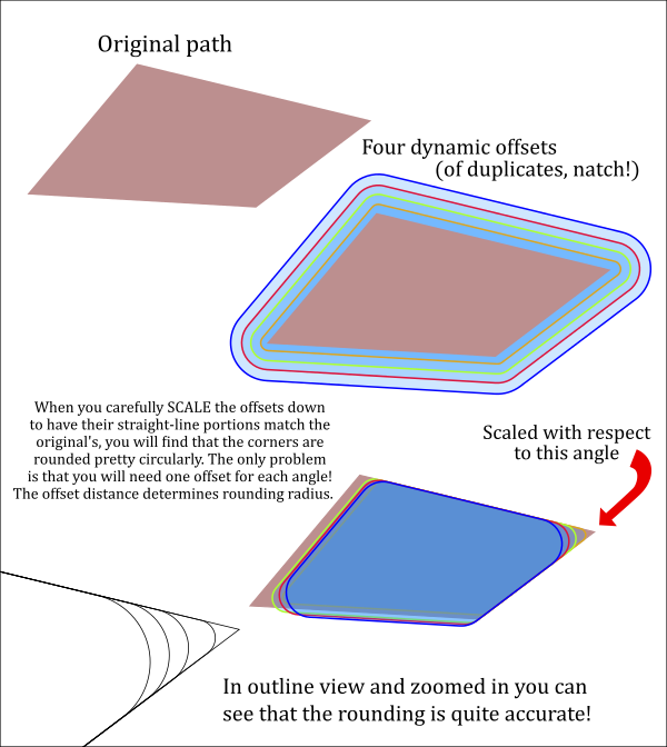

Hi Grobe, ~suv has shown you a very nice and accurate construction method, but when you said
I felt I had not described my suggestion very accurately, so here's a little graphic that might explain better.
I am not sure if you understood the other method, making an arc using the ellipse control bar - or just did not like it, but I thought I should explain
Grobe wrote:The main disadvantage of using dynamic offset is
The whole outer line moves outwards. I need the object to stay put and not grow in size.
Cannot precisely control the bend radius.
says 180 MINUS the angle of your corner .... looked like a dash, and probably made no sense. If you need more explanation let me know.druban wrote:The angle of the sector you will need to round your corner will be (180 - the angle of your corner).

I made a graphic showing the ellipse tool method, i hope it's a better explanation than before. No use of special developmental or deprecated tools. I had a little method to bisect an angle here http://www.inkscapeforum.com/viewtopic.php?f=28&t=12312&sid=5d35822c6c7b8c3772762f031731aa92#p46711 so I am carrying on from that point.Not terribly exciting eh.
