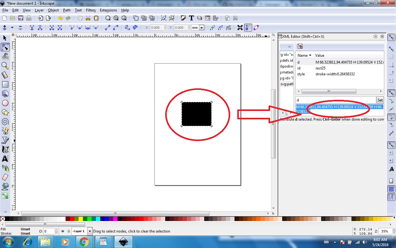

How can get xml source svg from path in my inskape extension for edit?
Exactly as xml editor from Inskape ... but i want to get only this for edit and save as gcode:
M 66.523811,94.404755 H 139.09524 V 152.61309 H 66.523811 Z

Already i open some files from inskape or downloaded from internet ... but is more code and not can understand where is lines that can make that or have to much parametrs , and put me in difficulty ...
I download tons of tutorials but i not find exactly that i want:
A sample example for edit self.svg , file that actually in inskape !
Thanks anyways!

See here for an example: https://gitlab.com/inkscape/inkscape/bl ... des.py#L85

I thing that i find in another topic exactly that i want!
http://www.inkscapeforum.com/viewtopic.php?t=8826#p31912
Thanks anyway for your response!
Regards!
Code: Select all
#The 'd' attribute is where the path data is stored as a string
pathData = node.get('d')http://www.inkscapeforum.com/viewtopic.php?t=8826#p31912

Now i begin study addnodes.py after i understand some things... thanks again!
I not understand what is mean [:]
Code: Select all
new[-1].append(next[:])Re: extension get and edit svg path
Append a copy of 'next' to the last item of 'new'.
