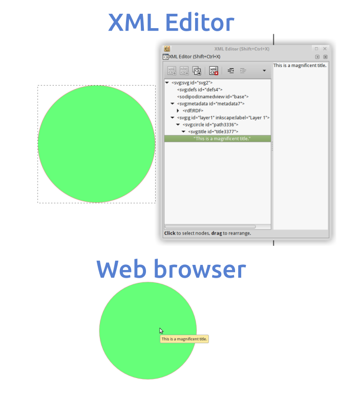

Sorry for deleting my post, but it didn't work when I tested. I've found another way.
(this is for adding a title to SVG objects when you do not care about styling of the tooltip - if you do, there are ways to add CSS, or you can use javascript, indeed. What I haven't tested yet is whether it works when you put this into an <img> tag. It works standalone (when you only open the SVG in the browser).
1. Select element
2. Open XML editor
3. Add a new node to the SVG. Name it
4. Add a text node to that node. Enter your hover text.
5. Move the title node into the object that you want to have that hover text.
Save file.
Open with web browser. Hover.
1. Select element
2. Open XML editor
Code: Select all
svg:title4. Add a text node to that node. Enter your hover text.
Save file.

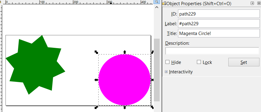

sineadco wrote:I want to create tooltip/mouse rollovers on parts of an .svg image so that hover text displays to user with more info when they mouse over. I'm not a programmer so I don't know how to use Javascript or scripting languages to do it.
If you download and open this svg in a browser, the hover will show the title.
https://dl.dropbox.com/s/5sfoujothrsm6u7/HoverTip.svg
Open the object properties panel for an object and enter info in the title field, then click "Set"
Depending how you embed in a web page, it might need some extra work.
Re: XIA 2.2 Extension won't work - Exception in Tkinter callback
Ah, Inkscape even provides a pre-made way for this. Didn't know - thanks, @tylerdurden
(at least I now know how to do it manually...)
Cheers @tylerdurden @Moini, thanks for steering me straight!
