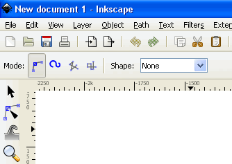

I'm using (still) 0.48.1 so this may already be known. I've made some dots with the Pen tool (Ctrl click) and then scaled them. (edit - scaled with Selection tool) Later if I add a stroke, the stroke widths appear to have all been scaled. Each dot's new stroke has a width that is wider, the larger the dot. So it appears to me, that even though I've deselected the option to scale stroke widths, the width is being scaled on dots (which I know are simply circles). I'm not sure which seems weirder -- the width being scaled despite the control bar button being deselected, or that the strokes are scaled while they don't yet exist!
I did find this bug report https://bugs.launchpad.net/inkscape/+bug/805392. I can't follow all the technical discussion, but it sounds like this was reported for the new renderer. So even though it sounds similar, it might not be.

before scaling and adding stroke.
