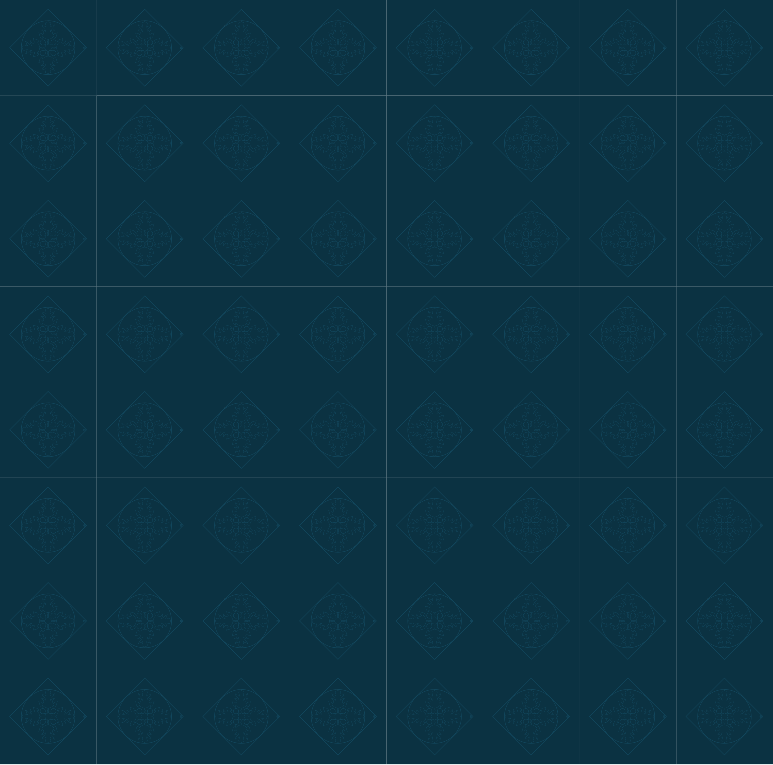

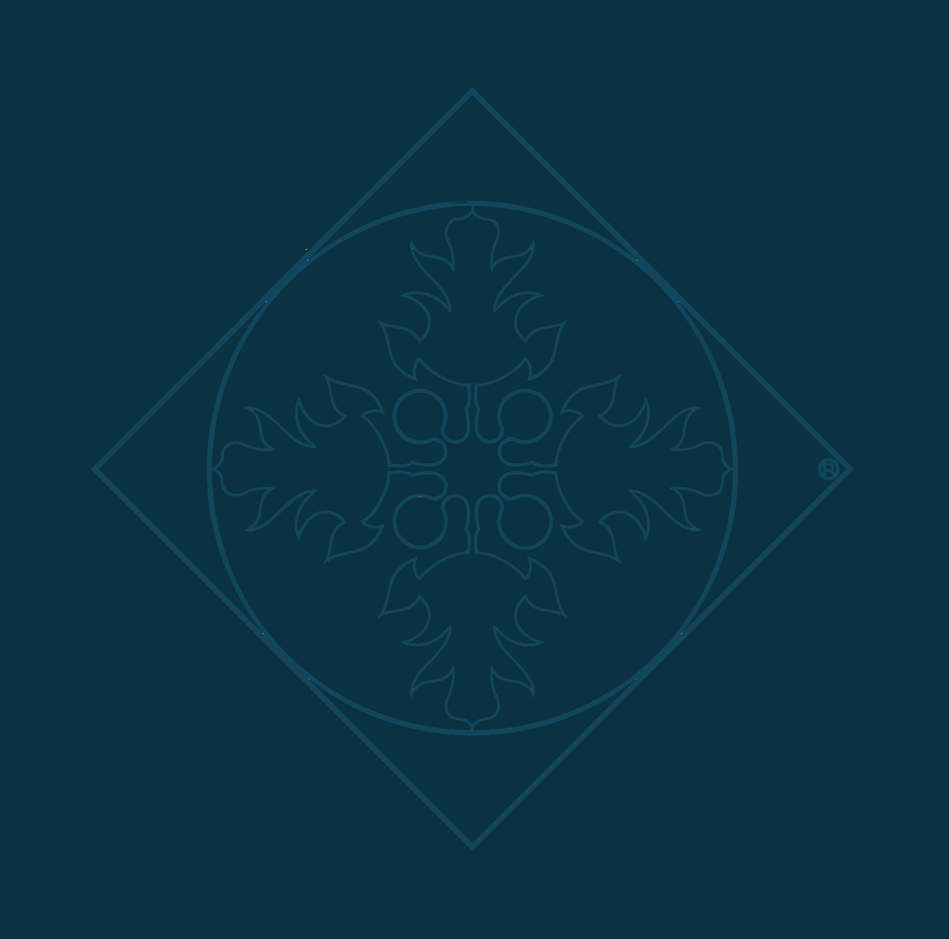

I have created a logo for my company and am attempting to create a background for my website using a repeating tiled pattern of my logo. I have had some success with this, but no matter what I do, I end up with visible lines that I don't want.
I have been through all the settings and have tried many things, to no avail.
Any ideas on what I'm doing wrong? (I have included attachements of both the tiled pattern, as well as the original logo.)
Thank you VERY much in advance!!
Tiled background has undesireable lines

Even with perfectly matching edges the background can show through due to anti-aliasing&alpha compositing.
You can put a rectangle with a solid fill to the background or
convert your tile to a pattern fill and use it on a larger object.
Common issue, it was mentioned recently here.

Are you using 0.91 or 0.92? I had this issue with 0.91, and I am currently trying to create a tartan pattern on 0.92 - having issues with both the pattern template in 0.92 and blending lines of 50% opacity. If your issue of lines appearing is also in 0.92 I will run into it soon, though I haven't seen it yet.
- computerartclub
- Posts: 13
- Joined: Mon Jan 23, 2017 12:53 pm
Re: Tiled background has undesireable lines
I have just verified that the issue persists in 0.92 when using the clone tool.
I tried the seamless pattern template but experienced a range of issues with it so I have not been able to verify whether it is an adequate workaround.
Here is my attempt in 0.92 with the clone tool:
Try the seamless pattern template and see if you can figure it out. I converted mine into a pattern and filled a shape with the pattern but because everything outside of the page was semi transparent I could identify if the problem persisted. I couldn't figure out how to use the generated pattern in another file (it didn't come up in the list).

here is another solution, on 0.92 click object-> pattern ->pattern from object then create a shape and click object and fill -> fill -> pattern
works without a seam
the fast preview on the seamless pattern template has issues however:
