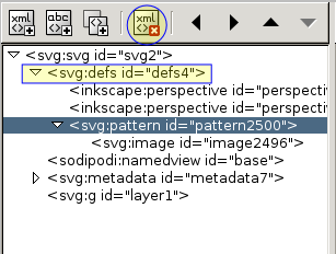

For now, the only way I know of to remove unused patterns is to remove them from the XML tree by hand.
Ctrl-Shift-X to open the XML editor...
Find the svg:defs section (should be near the top), and your svg:pattern node where id="patternName". (Click the little right-pointing triangles to expand sections if they're collapsed.)
Select that node line, and click the "Delete XML Node" button, as highlighted below. (Undo works on XML edits here, and edits are immediately reflected in the drawing, so you can always Ctrl-Z if you delete the wrong thing. Always a godo thing to save before you do anything drastic in the XML anyway.)
