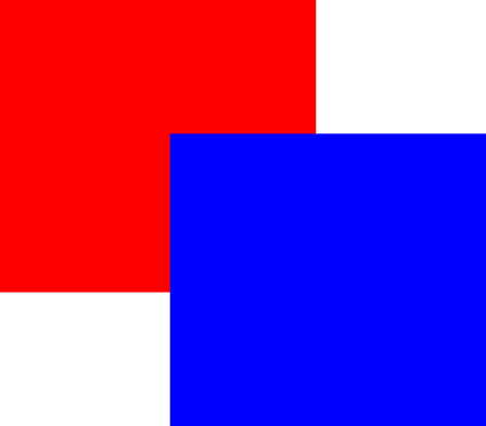

i am not really sure what this is called - but i know i have done it and now i cant remember how i did it.
what i am trying to do is ---- in the image is 2 squares and i want to remove the lower of the two but just the area that is under the top square- so the bottom one is an "L" shape -- i saw a video of it but i cant find that either. please help thanks ken

Select both objects the >Path >Difference (Ctrl+-)?

I think vwanweb is right. But I'm a bit confused by "top", "bottom", "lower", etc. If you mean the red one is on the bottom, vwanweb is right (and the resulting red "L" would be upside-down). But the red one is at the top of the page, and if you want a blue, rightside-up "L", you'll need to change the z-order of the squares.

that is kinda what i am looking for but when i tried it it worked but the blue square was gone - i am looking to keep both there but just adjust the nodes --
drynn: yes i didnt mean the top of page color i ment top layer - i want the red to be an "L" shape side ways and still keep the blue intack

No such functionality exists in Inkscape yet, but someone could easily write an extension for it. (Hint)
The workround is to select the top shape, copy to the clipboard, then select all, do 'ctrl + -' that's the 'difference' - and then paste back in place (ctrl + alt + v)

I use a similar approach to druban's suggestion, but without using the clipboard:
1) Select the top item (blue in this case).
2) ctrl+d to duplicate it in place. That leaves the new copy selected.
3) Shift-click on the bottom (red) object to add it to the selection.
4) ctrl+- (I use the minus on the numeric keypad) to perform the difference operation.
