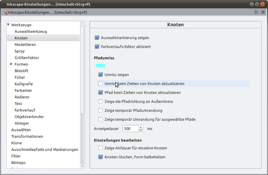

More detailed description. I experimented with the settings inside the node options. If i deactivate the the option i marked inside the screenshot with the mouse cursor (don't know how it is called inside the English translation), then it does not happen anymore. In effect the drawing is changed while making modifications, which can be much slower then just updating the outline, but it does not show the bug. Guess this "new" feature, introduced in 0.47 is causing the problems with the event handling. It should ignore the drawing lag, like the traditional method does.
