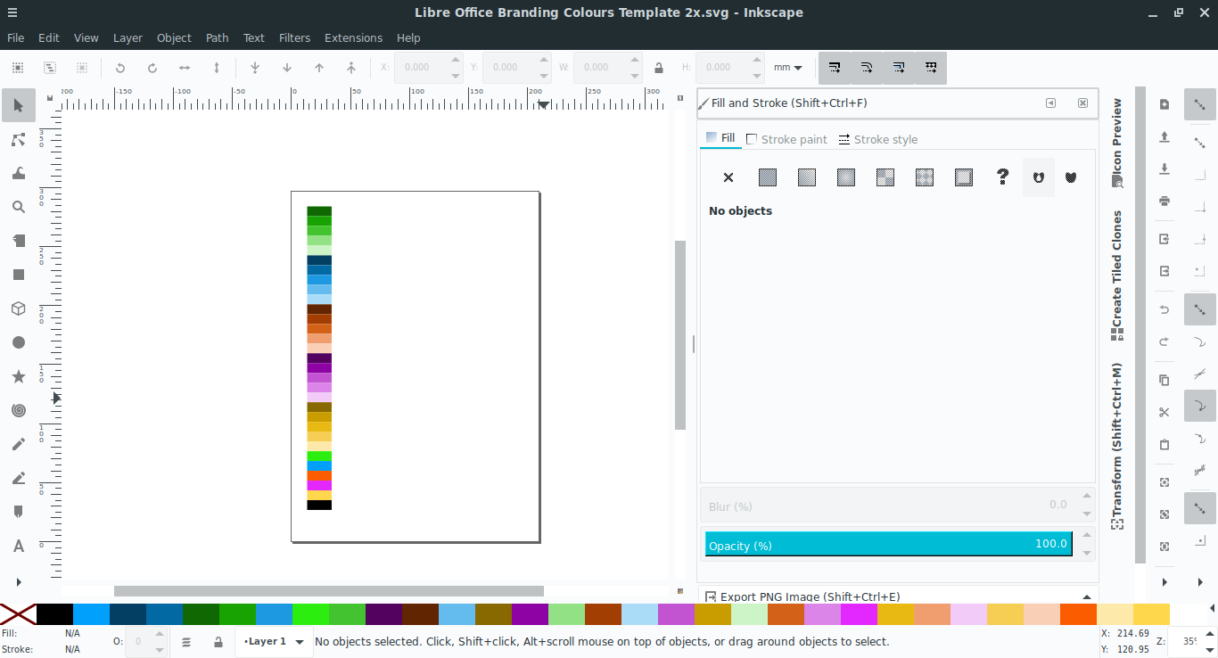

I was able to create a .gpl file colour palette which is working fine with Inkscape. Sadly, the colours auto arranged themselves in some funny order. Probably from ffffff to 000000. All I had to do was create rectangles of desired hex colours and then save as .gpl using Inkscape. Now that I have placed the .gpl file in the palette folder and restarted Inkscape, all the colours are available when I choose the palette by name, sadly, in a messed up order. It will be great if someone can suggest a fix. Thanks.
Please see the image below for the order in which I have stacked the colours and how it ended up appearing on the palette

As you can see, Black takes the left extreme and White takes the right. All other colours are arranged based on hex code between these shades. I am attaching the gpl file, just in case that changes anything. There is a specific order of hex codes as how it arranged between Black and White.
