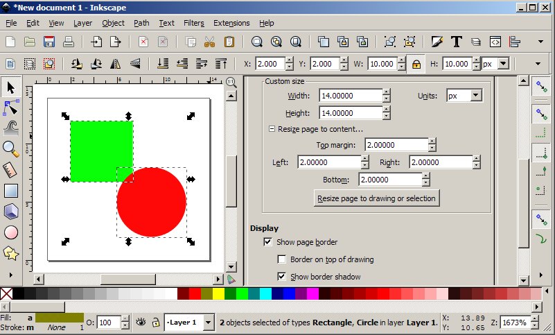

Re: Image size and canvas
I think that I understand.
Referring to the figure.
The large black rectangle is the page and is 10x10 px with a 2px margin (not page).
Am I correct?
Am I correct?
The margin is also the page.
The large black rectangle is the page border with shadow displayed.
It was made by resizing the page to selection, with 2 px margin settings, so it's size is
2 px left margin + 10 px selected objects bounding box width + 2 px right margin for width,
and similarly 2 px top margin + 10 px selected objects bounding box height + 2 px bottom margin width,
which is 14 px/14 px.
