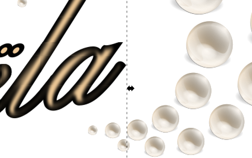

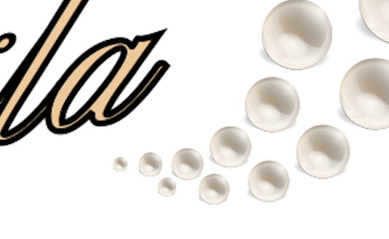

One of these is that the output that I see on the display is blurry in parts. When I save the image as PNG it looks correct, but not when seen in the software. Does anyone know how to fix this?
Pictures attached of both the saved PNG (how it's supposed to look) and print screen of how Inkscape displays it. You can see that only parts of the picture displays this issue (at the moment it is the text that has been transformed to a path).

Are you using a hidpi screen? If so, there's currently no solution for the problem. You will need to tolerate this until the next major Inkscape version is published (which formerly was called 0.93, but most probably will be 1.0 instead, or, a bit earlier, an alpha version of 1.0).
Re: Inkscape on Mac gives blurry display of objects
Ah, gotcha. I'm using a MacBook Pro with Retina display so that's probably the issue then. Can't wait until the next version if it fixes the problem! Thanks for the reply.
