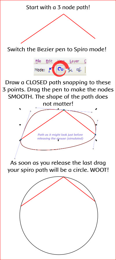

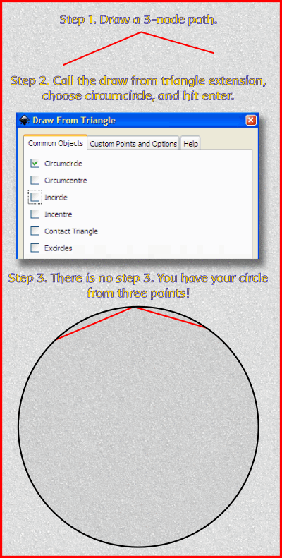

I disagree respectfully, Ragnar's method is absolutely accurate, he did not mention (but he did illustrate) that there is a 'snap to midpoint' when you draw the rectangle that makes it precise. You don't need to be zoomed in or estimate the placement.
Grobe wrote:Only thing I do different is that I uses guides insted of boxes.
The reason to use a rectangle instead of a gude is that you can rotate it and always have a right angle in the corner. For this purpose a guide would be useless, although in 0.49 we will have relative snapping of guide rotations which will allow you to snap to the midpoint and then rotate the guide 90 degrees.
You also did not mention why you don't want to use the draw from triangle extension?? This is really as CAD as it gets - draw a three point path and pick the extension and hit enter, and you get a circle.
You can go looking for the dev version r11789 which is the last one compiled by Uwe Scholer for Windows that has the Draft LPEs in it. They include circle by center and radius, circle by three points, mirror symmetry, perpendicular bisector etc.The difference between the LPE circle by 3 points and the draw from triangle is that the LPE is of course always editable with the node tool.

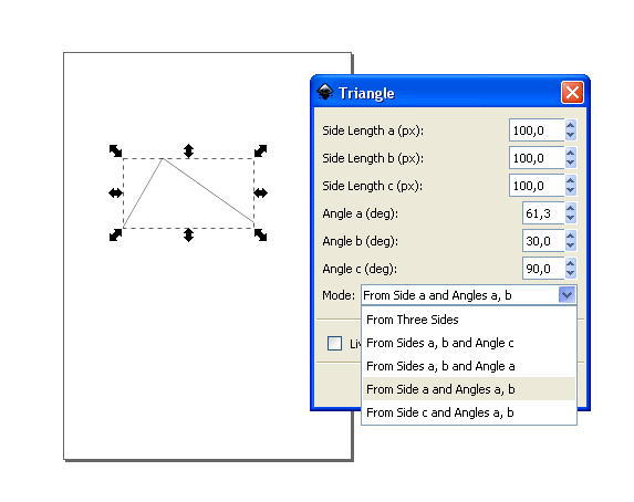

Re: I request more CAD-like features
Your Triangle extension user interface looks totally different from what I have.
I find this extension under Extensions ---> Render ---> Triangle. It sure doesn't look like the one you have, thus I did not understand why that one was useful.
I run test version, Inkscape 0.48+devel r12042 - and there is only one "Triangle" that I can find.
[edit]
I got the same result with stable version (Inkscape 0.48.4-1, portable). Cannot find the extension you're reffering to here.

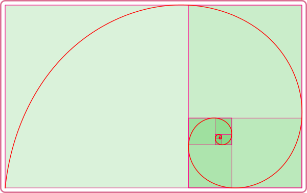

Here is your ultimate solution! I dug deep!
The original question was swamped by another issue, but here is a simple way to make a golden proportion rectangle in Inkscape.
I. Draw a square.
2. Duplicate it.
4. Resize the duplicate from one side until the moving corner snaps to the midpoint of a side of the square below.
5. Make a guide.
6. Rotate the rectangle until the corner snaps to the guide.
Hi druban.
Clever way to make the circle connecting three points - I'am impressed!
Took quite a few "practice rounds" to get it right!
Trying your golden ratio rectangle method I end up with a rectangle with side ratios of 1.5 - are'nt the golden ratio approx. 1.6180339887498948482045868343656?
I might be wrong, it has happened before
(Now I am old enough to admit it as well!) - or I am not following your instruction closely enough. That has also happened berfore!
Hi Ragnar I fixed it - it was my memory getting two different kinds of spiral confused! I updated my original post above, for the method as well as the spiral. Let me know if I made some other error!
Here's a comparison of the easy to draw but inaccurate Spiro path (blue) and the "real" hard-to-draw Fibonacci spiral, made of joined arcs (black). Inkscape circles are not absolute circles (AFAIK) so by the time you get into the center there is a tiny bit of inaccuracy...
