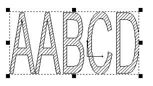

Hi
Please check the attachment as .jpg image.
Here i wants to hatch like attached .jpg file.
Let me know how to achieve with INKSCAPE.
- hatch.JPG (15.79 KiB) Viewed 7846 times
Re: Filling Hatch in Text with Eggbot Option.
In the fill and stroke dialog box the top row has choices of what to fill with, choose "pattern" and then from the drop down menu select the diagonal fill you like or is closest to what you want, and then you can edit it later ..

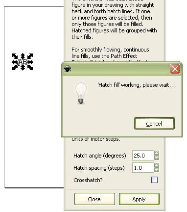

Hi...............
Im Try this function (menu 'Path > Object to Path') and Hatch Fill but my inkscape is crash.
im using Windows Xp service pack 2.core 2 duo.1gb ram.
so,any reason to crash the inkscape?
- In this condition im waiting for hatch but no result .and inkscape is crash.
so pls give me perfact method - 123.JPG (26.9 KiB) Viewed 7795 times
Milan1 wrote:Im Try this function (menu 'Path > Object to Path') and Hatch Fill but my inkscape is crash.
I don't know why the extension fails for you (or even crashes inkscape itself?) - it works as expected for me with Inkscape 0.48.1 on Mac OS X.
- Do other extensions work fine for you, or do they also fail or crash Inkscape itself?
- Does it work if you try to hatch a larger, simpler shape like a rectangle?
- Does it work if you ungroup the converted text and hatch each glyph separately?
- It might also be that you didn't change the fill and stroke attributes of the text and simply don't see the hatches (black strokes over black fill), or
- that your chosen settings (for spacing) would create too many hatch lines (too dense)?
Also, please consider asking these questions on the support sites of all EggBot-related things (links are in the reply I gave in one of the topics you posted earlier). The author of the 'Hatch fill…' extension (dnewman) is very active in the EggBot forum and user mailing list and might provide further help.

If I recall, from this and another topic, you have been having trouble with slow performance, even with native Inkscape tools. And I suspect the EGg-Bot extension needs even more resources (which would make it even slower).
One gb ram is really less than minimum system requirements for Inkscape. So if you expect to be doing this much in the future, you might consider adding more ram, if possible.
