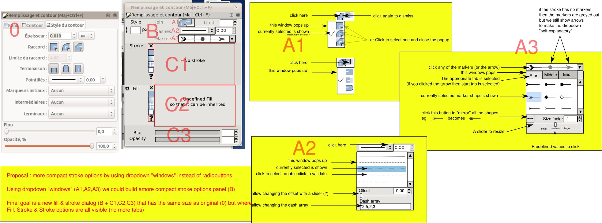

Proposal : more compact stroke options by using dropdown "windows" instead of radiobuttons
Using dropdown "windows" (A1,A2,A3) we could build amore compact stroke options panel (B)
Final goal is a new fill & stroke dialog (B + C1,C2,C3) that has the same size as original (0) but where
Fill, Stroke & Stroke options are all visible (no more tabs)
Proposal : compact stroke options
- proposal-compactstrokeoptions2.jpg (213.29 KiB) Viewed 3836 times
Re: Proposal : compact stroke options
Looks good to me!

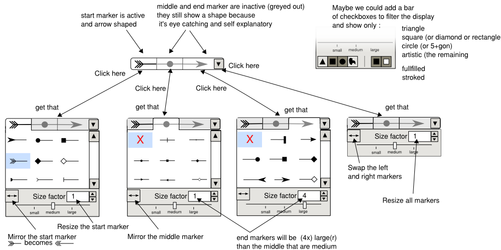

I like how you have the End Cap and Join styles right next to each other. It gives sort of a visual cue to their use. But I don't understand the Markers dropdown. Will it have like 3 buttons/zones for each menu item? Or will it be more like 3 side by side dropdown menus?
I'm not sure I understand what you mean. I hope attached proposition will clarify things
I removed the text tabs that led to confusion
In fact (now) there are 4 side by side drop down menus.
The dropdown arrow was there to give visual clue that there is a dropdown
eventually I used it to modify settings for all markers (start,middle,end)
