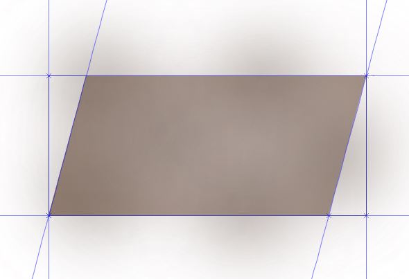

Re: How do I cut off the edge of a blurred object?
Here is a screenshot of the image. I am trying to remove the blurred outside of the rectangle.

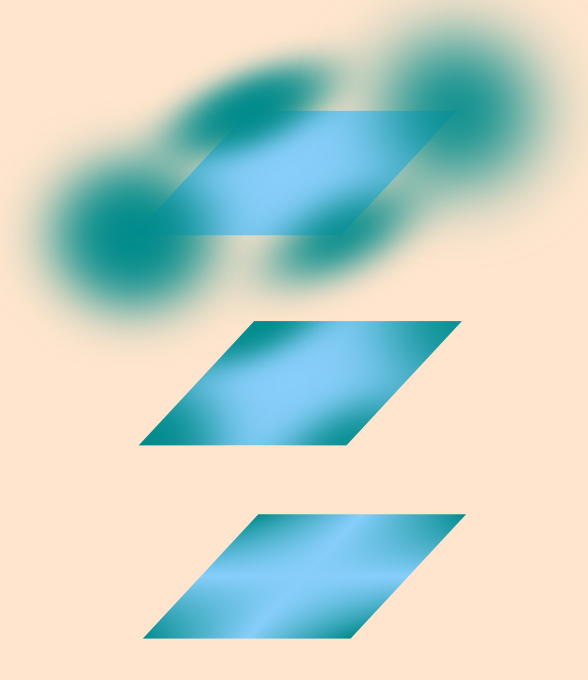

Clipping works just fine, and IMO is a better option than MeshG (the last one, for comparison) because the blur shapes can be edited individually. Remember to put the clipping shape on top unless you have changed the prefs. Grouping is unnecessary, and your problem was probably that your circles ere on a different layer.
Open the attached svg and see how things are layered.
