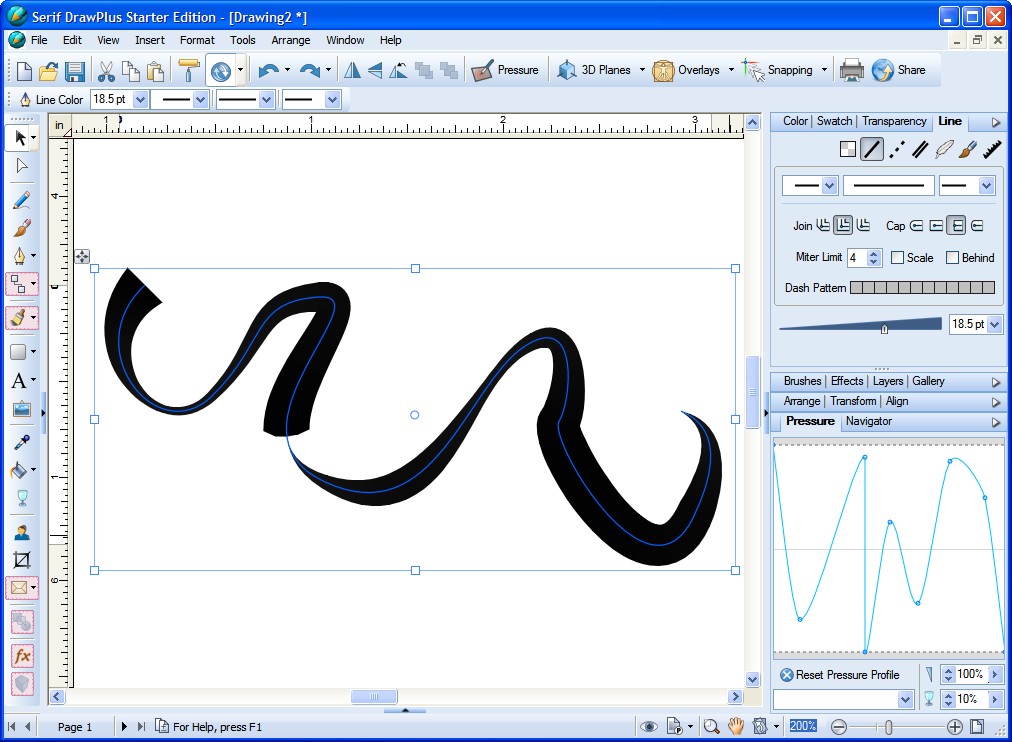

I've also purchased Serif Drawplus X5 to complement my Inkscape/Gimp work.
One nice feature is you can enable "pressure profiles" on any line created by a pressure sensitive tablet, or if no tablet, they provide a dialog to create a profile that can then be applied to a line or lines.
Here is a screen shot showing such a line and in the lower right corner is the profile editor.
The same thing can be done in inkscape's LPE, but not as easily.
-Rob A>
-Rob A>
