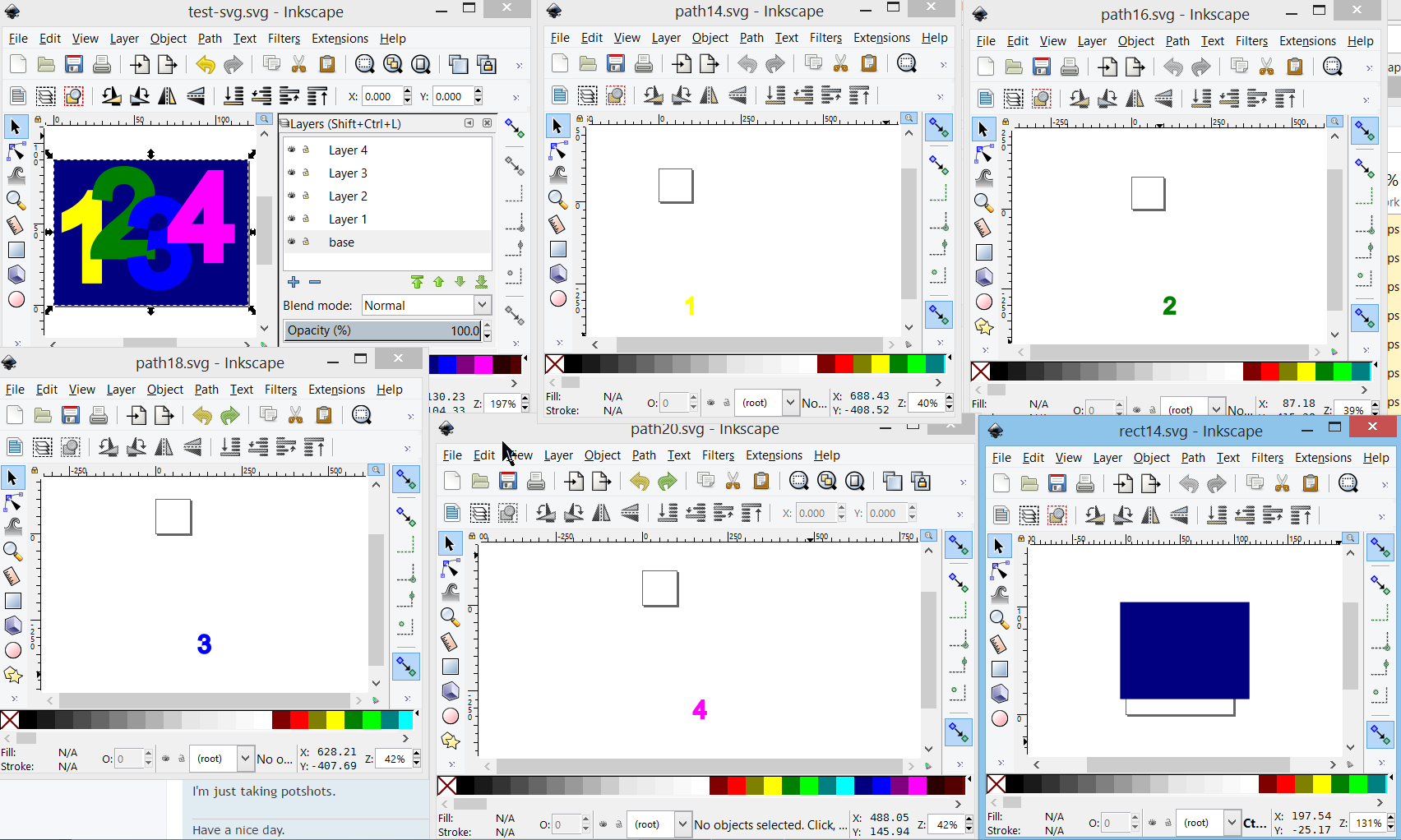

Well, the Vandam batch extension generates output, but maybe useful only in limited ways.
It seems the output of the Vandam extension only generates a 100x100 page, with objects correct scale, but improper location.
A batch export in it's best implementation (IMO) would maintain page size and object scale/location.
Not sure how sizing page to selection can be useful without a page size object in each layer; unless just the layers/objects divorced from other context are useful.
