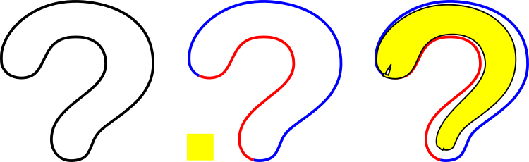

Maybe I am a step further?!
I used the LPE Envelope Deformation on the yellow square and split my shape into two paths and link the red one as "left bend path" and the blue as "right bend path" and disable top&bottom paths and then deform the square by "edit-on-canvas".
However, I haven't managed to get rid of the distortions at the begin and the end. I suspect that this has something to do with the angle of the handles. But couldn't remove it also with the usage of top&bottom bend path.
Maybe someone else knows what to do here?

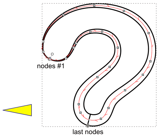

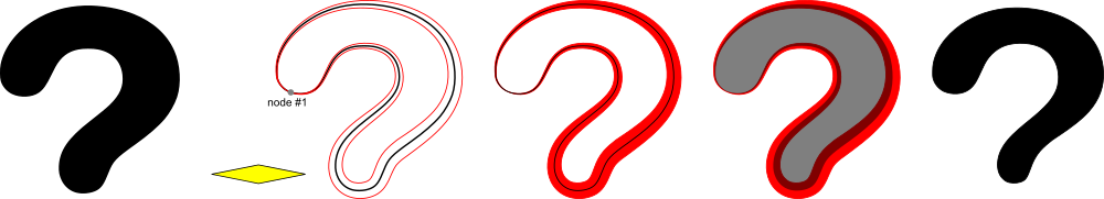

OK, here comes a solution...
maybe not THE most convenient direct-single-step-LPE solution, but at least A solution
- Select your arbitrary path (black)
- Make sure node #1 is at the desired starting position
- Use LPE "Pattern Along Path" and pattern the yellow diamond along the black path which gives the red path
- Do a Boolean difference between the black and the red path.
Done!
edit:
with the above procedure the thickest Pattern along path is not necessarily at the position where one would like it to be, because the outer/upper path is longer then the inner/lower one.
To define the position with thickest pattern
- split your path at the desired positions
- change path direction going away from node(s) #1
- combine path again (Ctrl+K)
- LPE "Pattern along path" the yellow triangle
- ... rest see above...
