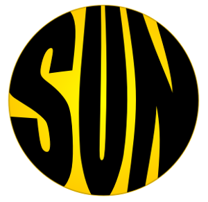

Like this? (quick-n-dirty)
- sample.png (36.09 KiB) Viewed 5774 times

Exactly like that heathenx, how is that done? I'm very new to Inkscape, there is so much to learn, I think that I might have watched some of your videos as while ago, does this process appear on one of them?

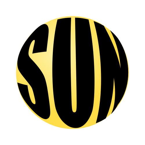

Here's my quick'n'hacky take on it:
1) Draw a circle
2) Create the text
3) Convert the text to a path
4) Apply the "Envelope Deformation" live path effect to the text path
5) Adjust the top, bottom, left and right paths for the LPE to get the sort of distortion you want
6) Clip the text path with a copy of the circle, just because I'm too lazy to spend all day tweaking nodes to get the edges perfect
7) Optionally convert the text path to a path again in order to "fix" the LPE distortion. This makes it a bit easier to subsequently tweak the fine details of the shape.
1) Draw a circle
2) Create the text
- envelope_distortion_LPE_on_text.png (23.25 KiB) Viewed 5523 times

Presumably this can be done to fill any shape by adjusting the nodes. This is brilliant, thank you both very much for the info.
