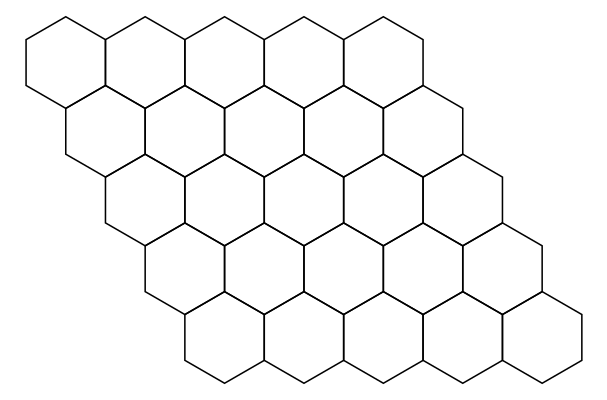

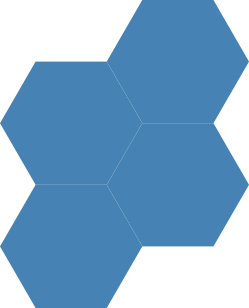

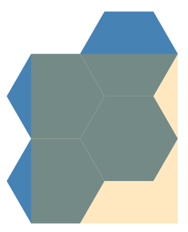

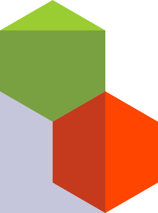

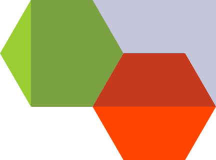

The use saved size checkbox in tiled clones may be interfering with your procedure of stroking after cloning. instead of what you are doing change to "visual bounding box" in prefs and see if that speeds things up.... but better choices are there that don't require inkscape to do a lot of calculating for the size of each group and stroke and bounding box...!
You may be expert in Inkscape, in which case please ignore the following, since I don't know exactly what you are trying to accomplish, but if you have come up with this method for creating a tiled grid of hexagons on your own, consider this alternative: a grid of hexagons is a simple P1 symmetry.
The following diagram is just one example of an object that can be P1 tiled to produce a hex grid:
Since inkscape uses the bounding box to tile, the objects will not interlock unless a new bounding box is defined. We can do this by creating a rectangle of the appropriate size, making it a group, tiling it, and then pasting the 4 hexagon object into the group.
The result is probably what most people want in a hex grid. The shifting method creates a tapering shape with extra clones that need to be deleted later. Note also that since the defining rectangle does not need a stroke the tile size is not affected by strokes on the subsequent elements.

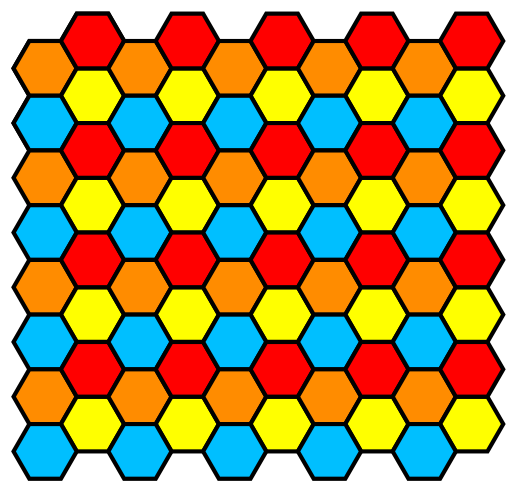

Trying to recreate your problem: it took my seriously old computer (Win10, Amd64, duct tape) 190 sec to unlink 1190 clones, 50 sec to ungroup 1192 groups, and about 10 sec to convert 1800 circles to paths. 6 sec to group 2390 objects.
Detail:
Detail:

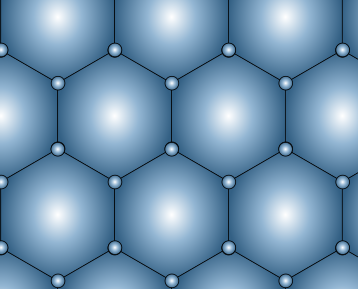

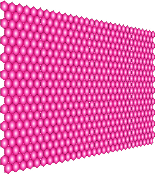

Re: Honeycombs
Think long and hard (if you have a slow machine) before clicking on path effects envelope/perspective with a 2390 object group selected! 7 minutes for it to process initially!! Every little move of the envelope is very slow to update. Working in outline maybe helped. Amazed that it did it at all really.
All the gradients were ruined of course... had to fix that, and the gradient tool is of course definitely much faster in outline mode.

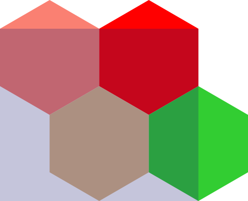

hi Julia the second example I used (gradient filled hexes) has the point at the top however the procedure is the same and the proportions of the rectangle too relative to the radius of the hexagon. (it is 3 radii X 2sqrt3 radii where the radius is the length of one side of the hexagon) You just turn it the other way.
You can use a 2 cell tile too, 3radii X sqrt3radii:
The other way too:
I don't use object manager very much so I never leave it open. I am glad that was the source of the slowdown.
The other way too:
