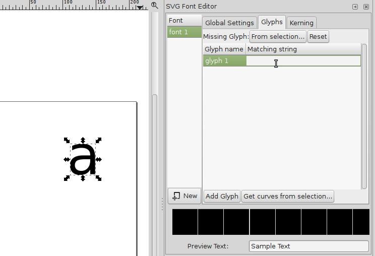

I have some questions regarding the tutorial you gave me
1. Do I have to draw the font? what if I have a picture font that I want to edit using inkscape? as much as I want would to draw the fonts in myself, I am using a mouse and the pencil tool isn't giving me a smooth, straight drawing, is there some way to get a straight line tool or something that can help me draw straight lines or can I just import an already existing font image and modify it?
2. The path it says "2. In the Glyphs tab, click on Add Glyph to indicate that you want to create a new glyph. Double-click on the Glyph name field to name your glyph, and on the Matching String field to enter the letter that it corresponds to."
I can only see the tab to change glyph name, it is labelled as "Glyph name Matching string" and there's only 1 input field, would I put in the glyph name and the letter it corresponds to in the same input field for example Glyphname1 A , meaning glyphname1 is the glyph name and letter A is the text it works with?
Re: Question on creating a font file (svg to tff)
1. You can use imported vector shapes, if you need those. For drawing proper lines, learn about the Bézier tool and the Node tool (or change the amount of smoothing for the pencil tool):
http://write.flossmanuals.net/start-wit ... -pen-tool/
http://write.flossmanuals.net/start-wit ... out-nodes/
http://write.flossmanuals.net/start-wit ... ing-paths/
http://write.flossmanuals.net/start-wit ... node-tool/
2. "Glyph name Matching string" - those are two fields. If the little divider in between the two isn't visible, that's a problem with your desktop theme. After adding a letter from selection, it automatically gets a glyph name that can be changed. Behind that glyph name, there's an empty field to double-click on.

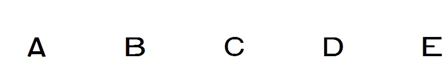

I managed to create the font but I have a little problem, when I type, the letters are spaced out wide.
I attached the picture below, would really appreciate if someone could help me out here. Thanks

Any suggestions on how to fix this?
Yes. Put them right on top of each other when you 'take curves from selection'. You could align their left edges, for example.
For fine-tuning the space between two letters, either use fontforge, or use the kerning feature in the other tab.
Moini wrote:Yes. Put them right on top of each other when you 'take curves from selection'. You could align their left edges, for example.
