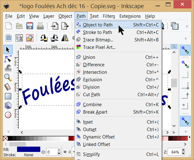

Internet Exploder might not support text on a path. You might try converting the text to a path.
- logo_Foulées_Ach_déc_16_-_Copie.svg_-_Inkscape_2016-12-23_09-03-50.png (63.3 KiB) Viewed 939 times
