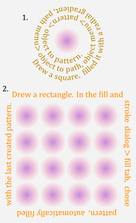

I was able to do this quite easily, LA, is there a specific problem you are having that you could explain?

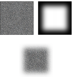

I interpreted the question a bit differently to druban, so here's my suggestion. One of us is bound to have got the right idea
I would do this with a mask. You will have one object containing your pattern, and another (possibly a group) containing elements of black, white and grey to use as a mask. I chose the sand pattern (with a bit of a wink - it gets used in almost all our comic strips!), and then created a group of two rectangles, one black, and one white. The white one was blurred.
Then I made clones of my object and group, aligned them, and ensured that the group (mask) is on top. Select them both and then right-click > Set Mask.
You could do this with the originals rather than making clones, but by using clones it's easier to modify the originals and immediately see the effect, rather than having to release the mask then re-set it. Once you're happy with the effect you can re-do it with the originals if you want.
I've attached the SVG so you can download it and play around with the shape and fill of the top row to see the effect at the bottom.

Yeah, I think Xav has interpreted the OP's request correctly, because now i notice that he said, "patterns and gradients are mutually exclusive..." which they are, because you can only specify one kind of fill for any object.

Yes, it sounds like Xav has nailed it. I've used masks quite a bit, but never with alphas. It sounds like this will work brilliantly. Thanks everyone!

druban wrote:Off topic:Incidentally, Xav, what is the purpose of the black rectangle in the mask group???
You're right, it's not really needed. I've just got into a habit of drawing masks explicitly using white and black (and the greys in-between) for a couple of reasons:
1) I find it a lot easier to see a translucent white rectangle against a black one, than against the white background of the page
2) It mirrors the layer masks in The GIMP which uses greyscale images, and in fact doesn't (as far as I can tell) allow transparency on the layer masks at all.
So no real purpose, just habit.
