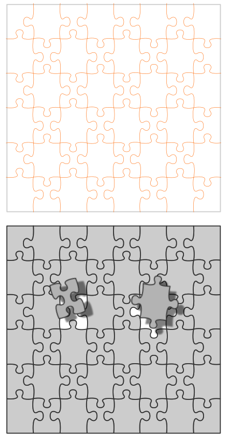

Thanks but that isn't exactly what I am looking for. Here is a picture of what I am trying to do. They're for educational puzzles.

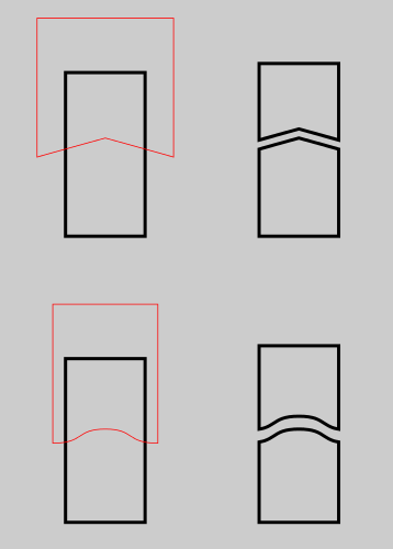

Thats a Boolean Operation then. Division.
- rect4161.png (8.92 KiB) Viewed 1698 times
Re: Splitting a puzzle piece
You can use Division to cut with a combined path a rectangle into individual puzzle pieces at once:
If that´s what you´re after.
