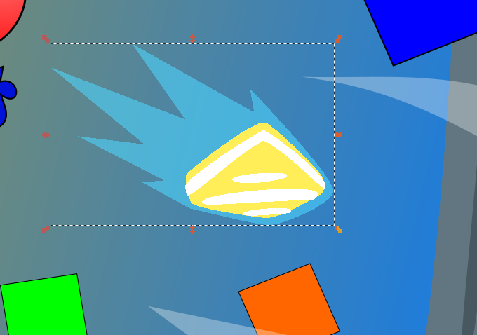

Hello, first time posting in here and have been using Inkscape for years now. And here's one of the issues I occur.
As I edit my SVGs in Inkscape, this happens on random objects I made. No, there's no Pixellize filter added. Is this a bug or something?
[Bug] Pixelated vectors

My guess is there IS a pixellize filter, sort of.
style:crispedges
If your svg has some source outside inkscape it likely ended up with such a style attribute.
Check those objects in the xml editor too.

picygaze wrote:Is the issue has been resolved? Because, I am still facing the same issue
Please share your svg here so we can point out where it has the shape-rendering specified to show aliased edges.
Re: [Bug] Pixelated vectors
Have you ever copy-pasted the object in Inkscape? It could actually have become a bitmap through that process, due to a bug of some sort.
