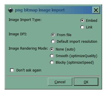

I just tested importing with 0.91, and for the first time, I noticed there's a "Don't ask again" box, which you may have checked. See attachment. I'll research how to undo that.
Meanwhile, there are a couple of extensions which might come in handy. If you select the imported image, and look at the status bar, it will tell you whether it's linked or embedded. Extensions menu > Images > Embed, if you want to embed it. Or Extensions menu > Images > Extract, if you want it linked.

Ok, look at Edit menu > Preferences > Bitmaps > Ask about linking and scaling when importing.
If it's unchecked, try checking it. If it is already checked, I need to research further

brynn, thank you so much. I dont recall ever clicking on Dont show again, but maybe I did by accident?
