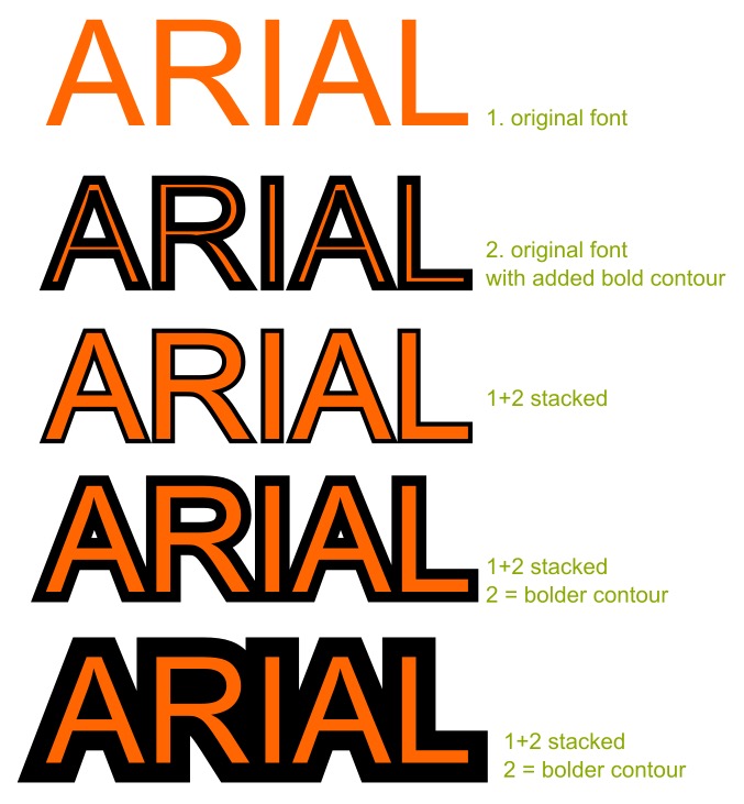

Re: increase path misforms my text
If your goal is a fat contour I´d go this route as a starting point:
polygon, since we now have the paint-order, the stacking is no longer needed (in your version, it might still be, though).
