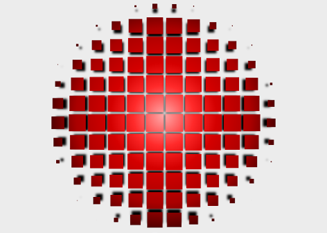

Videotutorial by Marco Riva aka zerocinquanta :
https://youtu.be/OsZiWk5-B80
Result:
Traffic lights with traced clone tiles (half tone effect)
- trafficlight.png (64.49 KiB) Viewed 6034 times

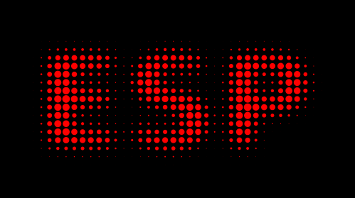

Not only do i love this effect (as can be seen in my previous work), but this tutorial gave me an epiphany or two (well sort of, lol).
I used to do this with blurred raster-images and always struggled with the effect, because it gave me the craziest (bug-like) effects.
Using opacity instead of lightness is a much better way for the tracing.
- Halftoned.png (24.01 KiB) Viewed 6022 times

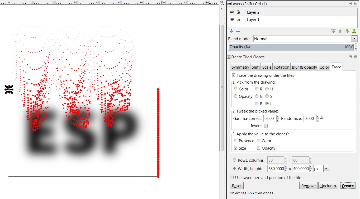

Here is one of said crazy effects (with a rasterimage as the base), and i think i know why it does that. Its because i resized the canvas to image size. It doesnt happen when i use the unmodified canvas.
- funk.png (167.46 KiB) Viewed 6007 times

Re: Traffic lights with traced clone tiles (half tone effect)
Resizing the canvas means adding transformation to the (parent)layer.
It is suggested putting everything on a newly created canvas once the page is resized and maybe even nudging path nodes...
Guess that would be an important feature to have a magic button to eliminate all the unwanted transformations.
Though it would be problematic on objects other than paths.
Lazur URH wrote:It is suggested putting everything on a newly created canvas once the page is resized and maybe even nudging path nodes...
mmmh, yeah. Its the same bug that sometimes happens when trying to make a sunburst with tiled clones. I know of that workaround.
I didnt realize its the same with the tracing option, because the result is so outrageous, lol
Why nudge a path node though ? Just wiggle it a bit ?

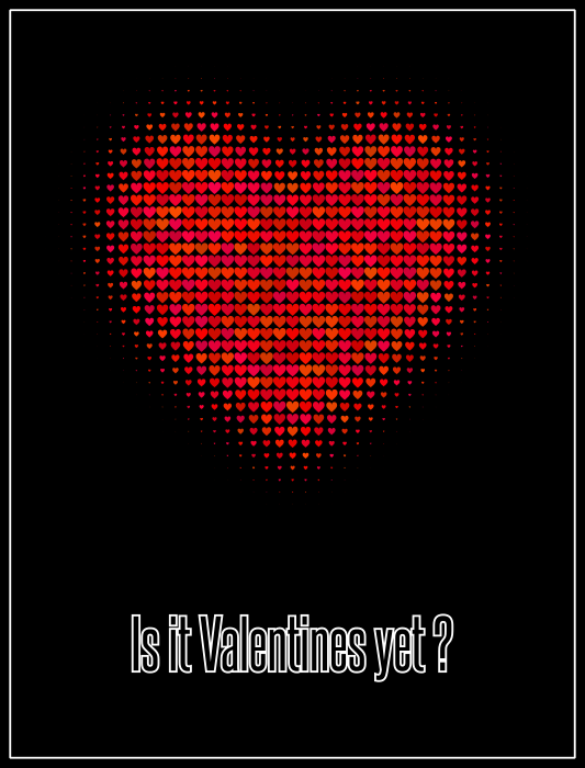

Excuse me while i hit the sky !
- Disco.png (108.7 KiB) Viewed 5976 times

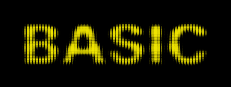

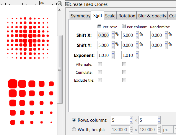

Trying different shapes (rounded rectangle) with size and opacity trace.
- Basic.png (78.2 KiB) Viewed 5953 times

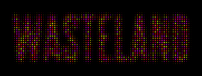

camp
- Oink.png (124.95 KiB) Viewed 5915 times

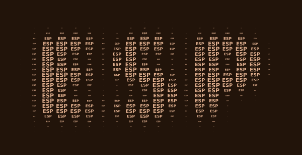

- ESP_esp.png (73.14 KiB) Viewed 5903 times
