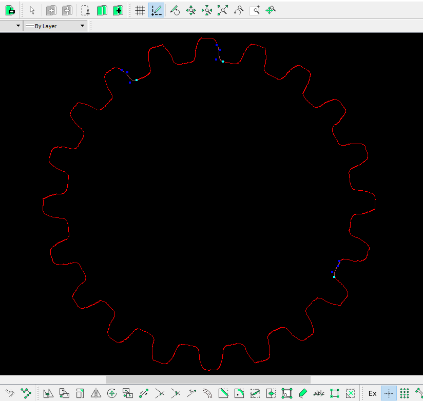

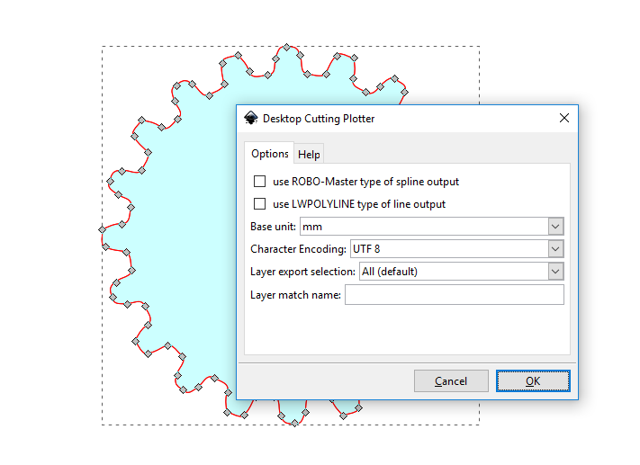

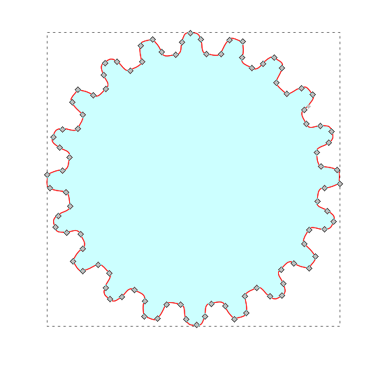

I am having problems to export a design to dxf. I am using inkscape 0.92 64bit in windows 10. In inskcape the svg file is a closed path, but when I exported to DXF a open with librecad to check it, I got a bunch of separated segments, because I want to laser cut, I need a closed path in DXF for the laser cutter to work.
I attached some examples images.

I don't know anything about this, but would maybe the polyline option do what the name implies? I think it would be worth a try.

Polyline sometimes works, but I'd check the accuracy of the shape before cutting.

I also tried all the options with with ROBO and POLYLINE, but neither of then worked, here is the svg file I am having problems with.

Hi, it is not hand drawn, is imported from gear generator, but I used simplify nodes trying to solve the problem.
