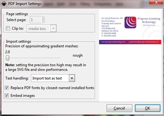

PDF import; I've had some issues with fonts myself. You ideally need the same fonts installed (with the exactly correct name) as the PDF uses, otherwise Inkscape uses substitutes, which you may well have to manually correct. Gradients: Inkscape certainly has gradients. I thought the problem was 'tother way round, with PDFs rasterizing vector gradients on creation; but I don't really know.

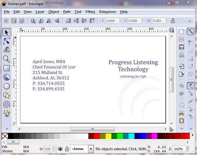

I have a number of PDFs that a graphics designer made for our business using Adobe Illustrator, including business cards, brochures, letterhead, etc. I need to open and edit the business cards to include/revise names, phone numbers and email addresses. As I said above, the PDF import settings dialog box previews the contents of the PDF correctly.
When I open some PDFs, some of the objects don't display that are gradients such as our logo and a bottom border on which the website and email addresses are superimposed. Text shows up incompletely. An example is the word "Officer" which shows up as "Of icer." But, this behavior is not consistent from one PDF to another. For some PDFs, all the objects show up and I can edit them.
The SVG problem turned out to be operator error. I saved the pages as a web-text instead of web-svg only.

This is a startup company that is not well funded at this point. Yes, I'm the computer guy that does graphics, website design, video, training, consulting, sales, customer service and writing. I have no funds to buy anything...ergo, Inkscape. We have horrendously expensive Adobe on our todo list when we make some money. I'll likely have no choice because some work was done in InDesign. Right now all I'm trying to do is take the PDFs we were given and make minor changes to our business cards. If I can do that with Inkscape, all the better, but using a trial of Adobe is on my list of backups. I still don't have all the uncompleted design work yet and want to get it all in hand before the 30 day clock starts. Dealing with the graphics artist is not possible at this point.
Well, I figured out a work around. I'll just take a card that shows all the objects, make a template and redo all the business cards. I could have already finished if I started that when I made this post. Sorry for the imposition.
