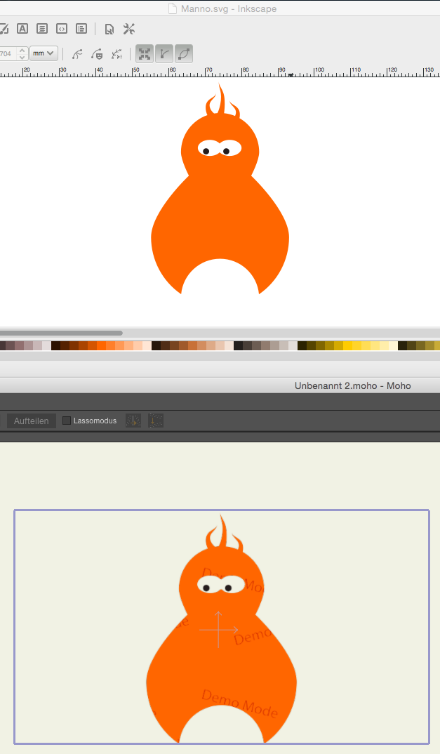

While AS Pro 11 is no longer available I tried their latest release in demo mode and can´t seem to have any issues with loading SVGs from Inkscape - wether it´s "Inkscape.svg" "normal.svg", "eps" or "optimized.svg" via shift+cmd+Y:
