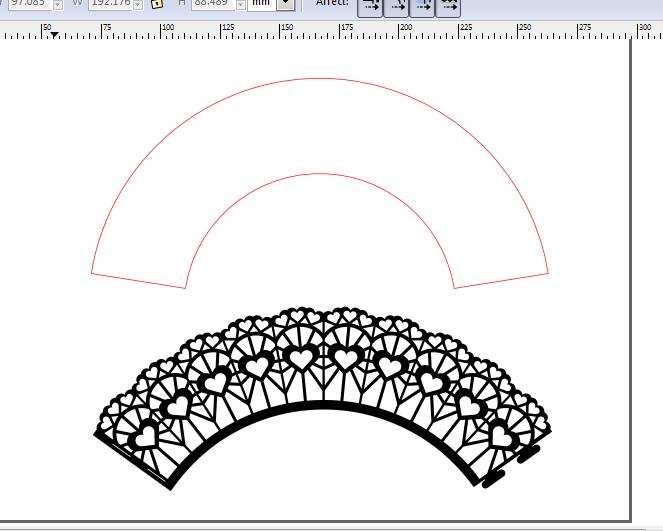

I have a drawn object that is on a radius. I need to resize it to a different radius.
I have attached a screen shot of the object and the new radius to help explain what I need to achieve.
the object consists of multiple nodes and I assume there is a method of adjusting the outer dimention nodes that will adjust all the others but I can't see how to achieve this.
I have tried to drag the original object to fit the the new curve outline but that does not work.
adjust object to suit new curve

Re: adjust objectto suit new curve
Womble wrote:I have a drawn object
Everything depends on what you mean by 'drawn' here! There is no good way to bend the whole object without distrortion, but if your original is in SVG it might be not much work to redraw this with the new curvature. If it is a bitmap then you will have to trace it first. In either case you would be using the basic pattern unit and repeating it with pattern on path or bend path effects or extensions. You'll have to make it rectangular first BTW.

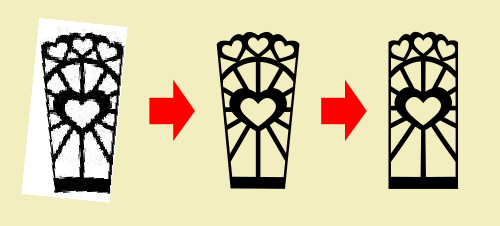

Re: adjust object to suit new curve
I meant that if you want to use either of the pattern on path methods the pattern unit has to be rectangular for the edges to match up. I redrew it for this example but you may not have to if you have a vector image. still, it might be cleaner to redraw anyway. There's really only 3 elements here, the heart, in 2 sizes, an arc and rectangles.
