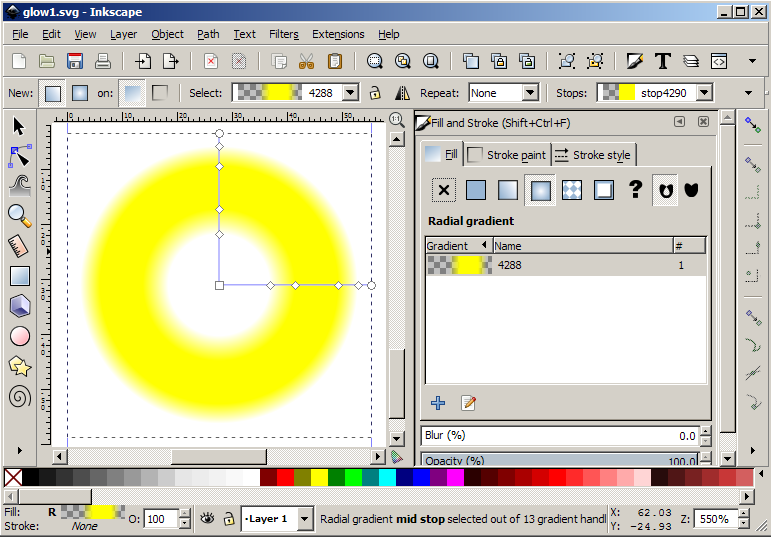

You might try making glows with gradients, where you have more control over the falloff.
- coin-tdSS.png (74.8 KiB) Viewed 1222 times
