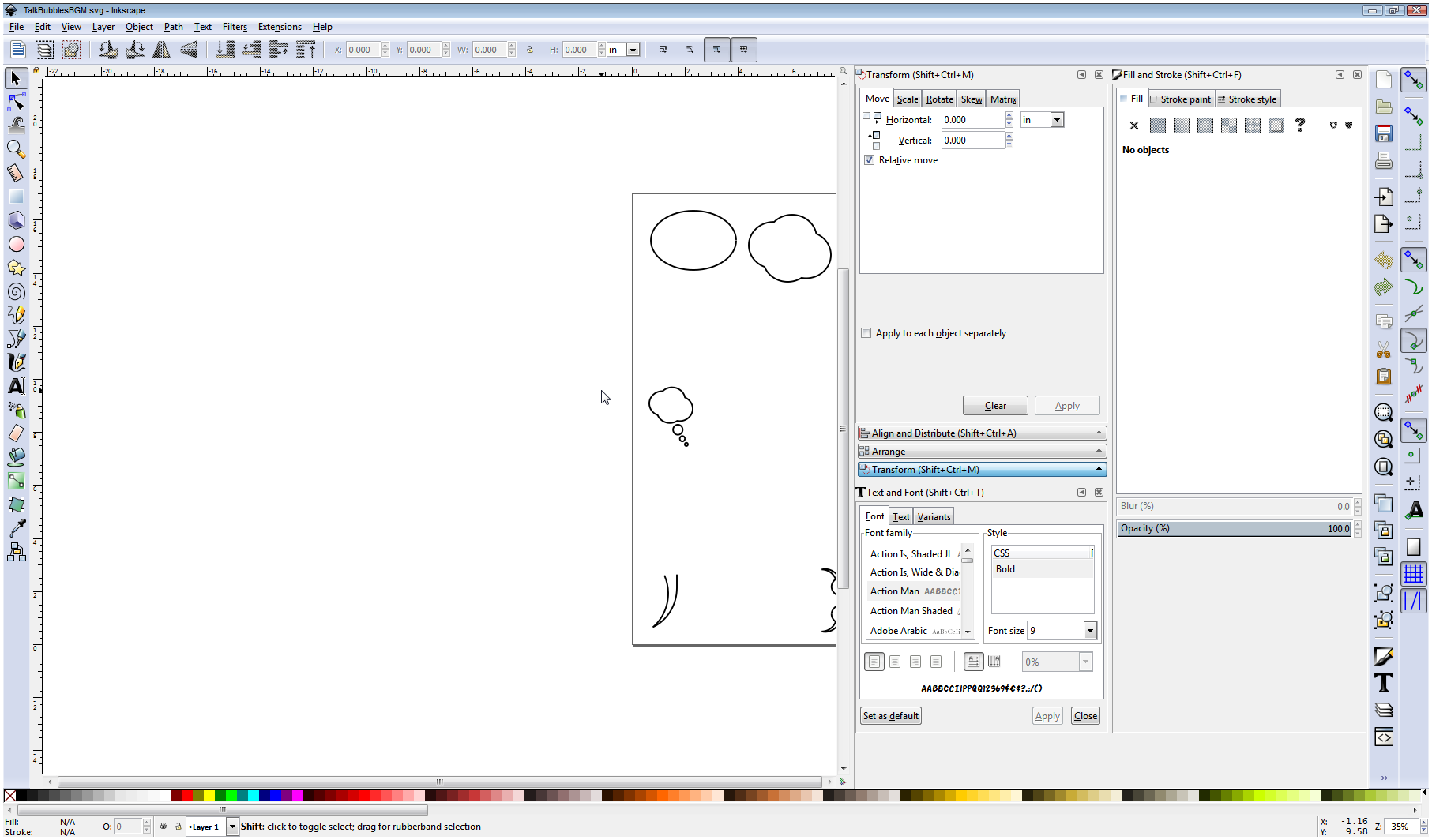

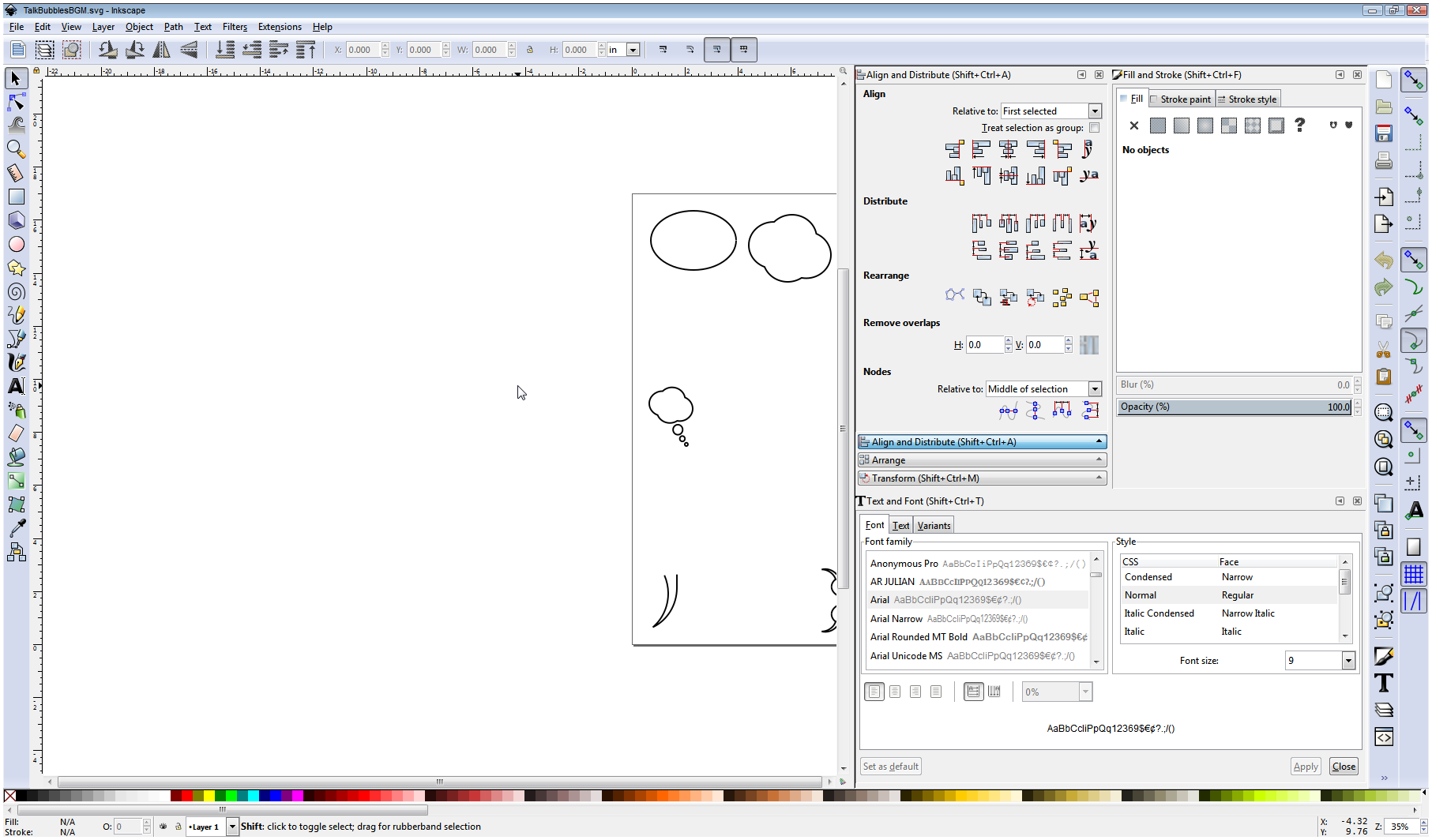

Here is my desired layout:
Here is what it saves and restores:

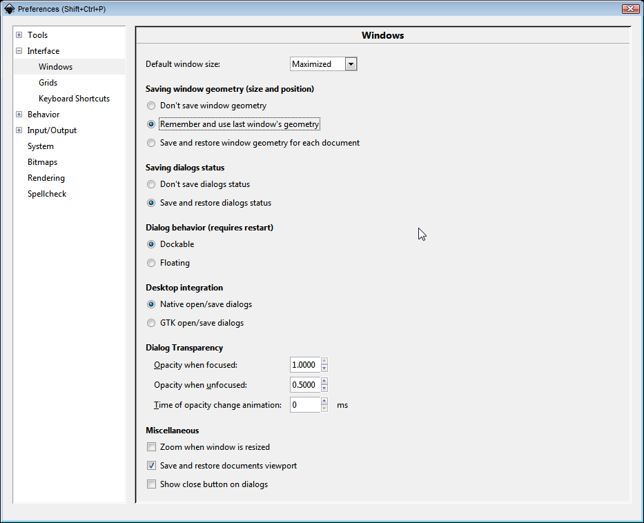

Here are my dialog settings:

You might check Inkscape Preferences > Interface > Window
And check the option to remember the dialog status. The op showed a screenshot you can follow.
