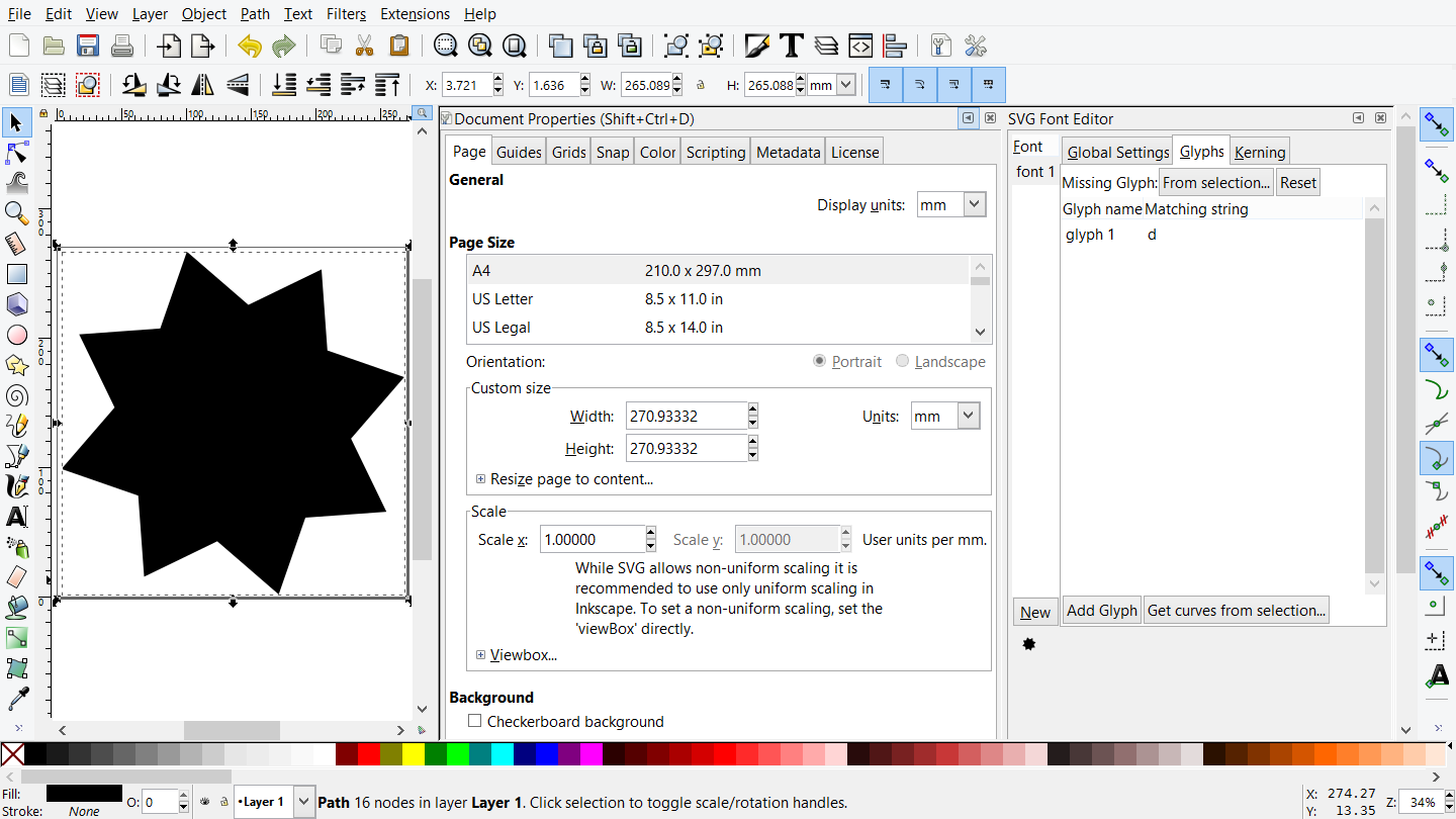

I have a problem with displaying a thumbnail "SVG font editor"
Can anybody help me?
images ------> http://savepic.ru/13387517.png
The picture is small, but it should be big
This is the "SVG font editor"
"SVG font editor"

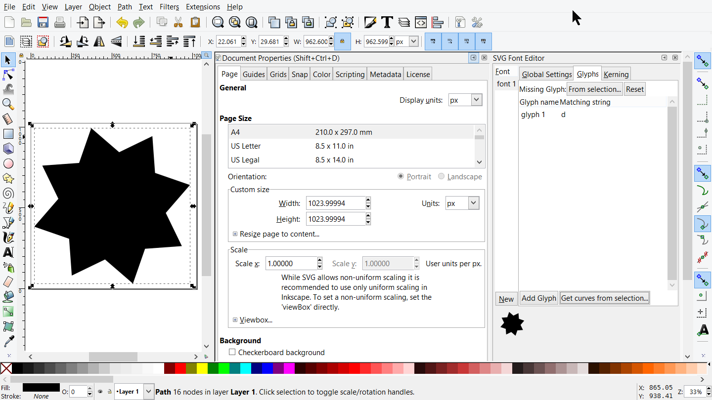

Re: "SVG font editor"
Thanks for the file. Might be a scale issue.
I'd use px as units and scale = 1.
- Font-unitsPX-scale1.svg
- (3.39 KiB) Downloaded 158 times
Thank you!!!! Everything worked out!!
