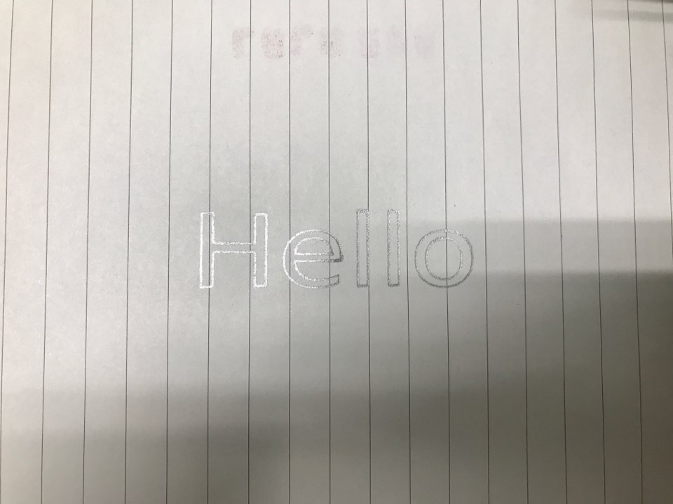

Hello everyone
I am trying to figure out ways to print words and sentences using inkscape!
The problem is if I upload an image file with words on it or directly type texts on the layer, the program traces the outline and prints letters in the form of outline writing.(like the attached image)
The result I want is to draw letters and sentences in forms of strokes like a person's handwriting.
Thank you for your help!
(Since it's my first time using inkscape it would be very helpful if you give me specific instructions)
How to print lines
How to print lines
- XYplotter result.jpg (60.98 KiB) Viewed 1543 times

Re: How to print lines
Hi thank you for replying.
I guess my explanation was too vague.
So basically what I'm trying to do is to make my xy plotter(pen plotter) write words and sentences using inkscape. Like in this clip: https://www.youtube.com/watch?v=3ohDaX4uxKY
I downloaded the latest version of inkscape, got Hershey text, wrote a few words, chose a font face and clicked apply.
Then, I went to Idraw control and clicked apply to start the pen plotter.
The result is as in the last image. (Outline text)
Am I doing everything wrong? or is it just not possible to make a pen plotter write normal sentences using inkscape?
This is the text, action and font face I selected in the Hershey Text extension.
- step1.png (114.87 KiB) Viewed 1439 times
Maybe I can't see well because it's small, but that looks like what you described that you want?
Yep, looks like that to me, too. Unless you do 'Stroke to path' on the letters later...
