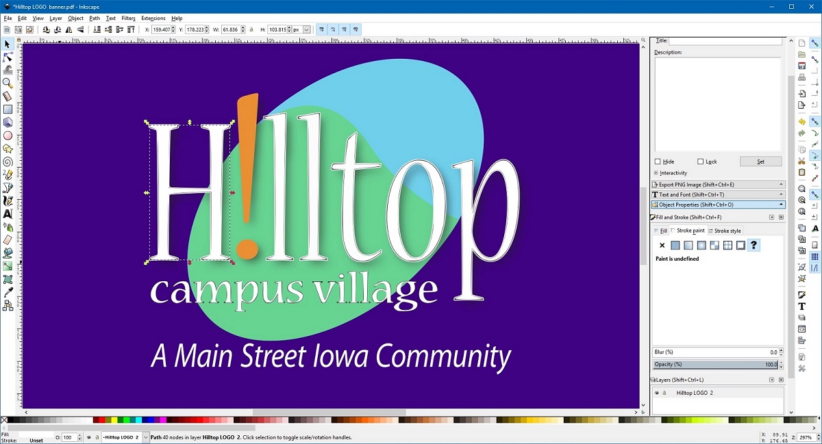

I'm not a graphics guy. I use MSPaint for my graphics needs. That said, I'm on the board of a non-profit, and I find myself increasingly needing to edit vector art to send off to order banners or whatever. I downloaded Inkscape after someone telling me about it, and have been learning a tiny amount. The problem is I need to order a couple banners soon, and I'm having issues changing the text color without ending up with a weird outline I can't get rid of. I found this thread and thought I was set, but the instructions in there don't seem to work for me. I would assume the "text" in my image isn't technically text to the program, but more of a shape? I'm seriously clueless here, and appreciate any help I can get. I was simply trying to take the first image and turn it into the 2nd image.

The status bar indicates that stroke is "unset"... I'd try setting it to "none".

Re: Extra outline/stroke in kinda text?

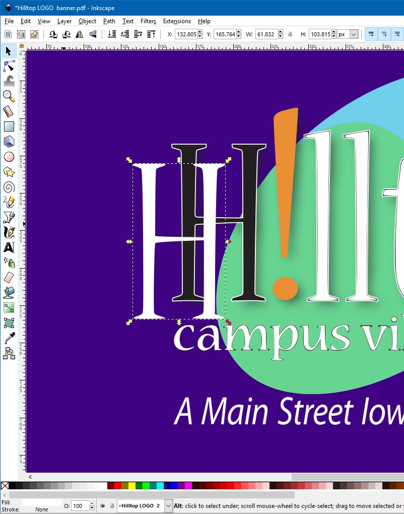

I did try that, and it didn't appear to do anything. What I just discovered is that I can select the letters and drag them away, and it appears there's another black letter outlined in white beneath them that is causing the issue. However, I can't select that letter by itself.

I'm gonna guess a trace or bucket tool was used, and an original image is in the background.
At this point I would add a thin stroke to the white letters to hide the black letters (and their white outline).

Wow, that worked perfectly. Thanks a ton, got my banners ordered in time for Saturday's event. (We're a last minute type group...)
