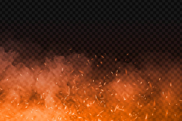

Recently bought an image on iStock, and I got as far as opening the image on inkscape, but I'm unsure on how to remove the gray and black checkered background to make it transparent. If anyone has any tips for me I'd really appreciate it! Thanks!
Re: Help Removing Gray and Black Checkered Background
As you probably cannot share the picture, please let us know what type of object the background is.
Moini wrote:As you probably cannot share the picture, please let us know what type of object the background is.
It’s a picture of fire and smoke with a gray and black checkered background that’s the same pattern as a regular transparent one. I was told that the image could be edited to be transparent in a vector software but I can’t figure out how to do that.
I attached the image that I just saved from my phone so you’re able to see what I’m working with.
Thank you.

Is the checkered background part of the picture, or part of the background of the application you're using to view the image? The image you bought, is it a jpg image?
If you bought a jpg, then Inkscape is not the correct software to edit the pattern out. It would probably be smarter to look for a picture without checkerboard pattern, in that case.
So, what's the file format?

The file format is EPS but there’s also JPG files I can download as well. I was told by the website I bought it from that I can make the background transparent through any vector software if I used the EPS file.

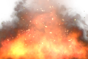

Uggh - I´ve never seen a mess like this in my whole vector drawing career in the last 3 decades. None of my Inkscape versions can open this file at all. Affinity Designer+Photo will open but confront with over 3k bits&bytes of raster images, masked, blend, applied filters etc. I have no clue what´s the purpose of this kind of file. I doubt you can edit in any case - I could be wrong though.
I received the file.
Imports just fine in Inkscape master, but does not contain vector fire, just two embedded raster images, with lots of checkerboard elements still in them (after removal of the clipping and grouping and the little checkerboard tiles).
This file cannot be edited in the way you want with Inkscape.

As I said I had no problem to load it elsewhere (macOS will converts EPS into PDF on-the-fly) but I still doubt that there´s any useful editing possible with that file.
I can´t determine any transparent area in this file and it´s all raster image based - 2266 tiles/clones/parts etc masked by vector shapes for what ever reason.
If a simple fire,smoke&ember image with translucent background is your goal like this particle simulation from my video editor it´s probably a case of 2 minutes:
