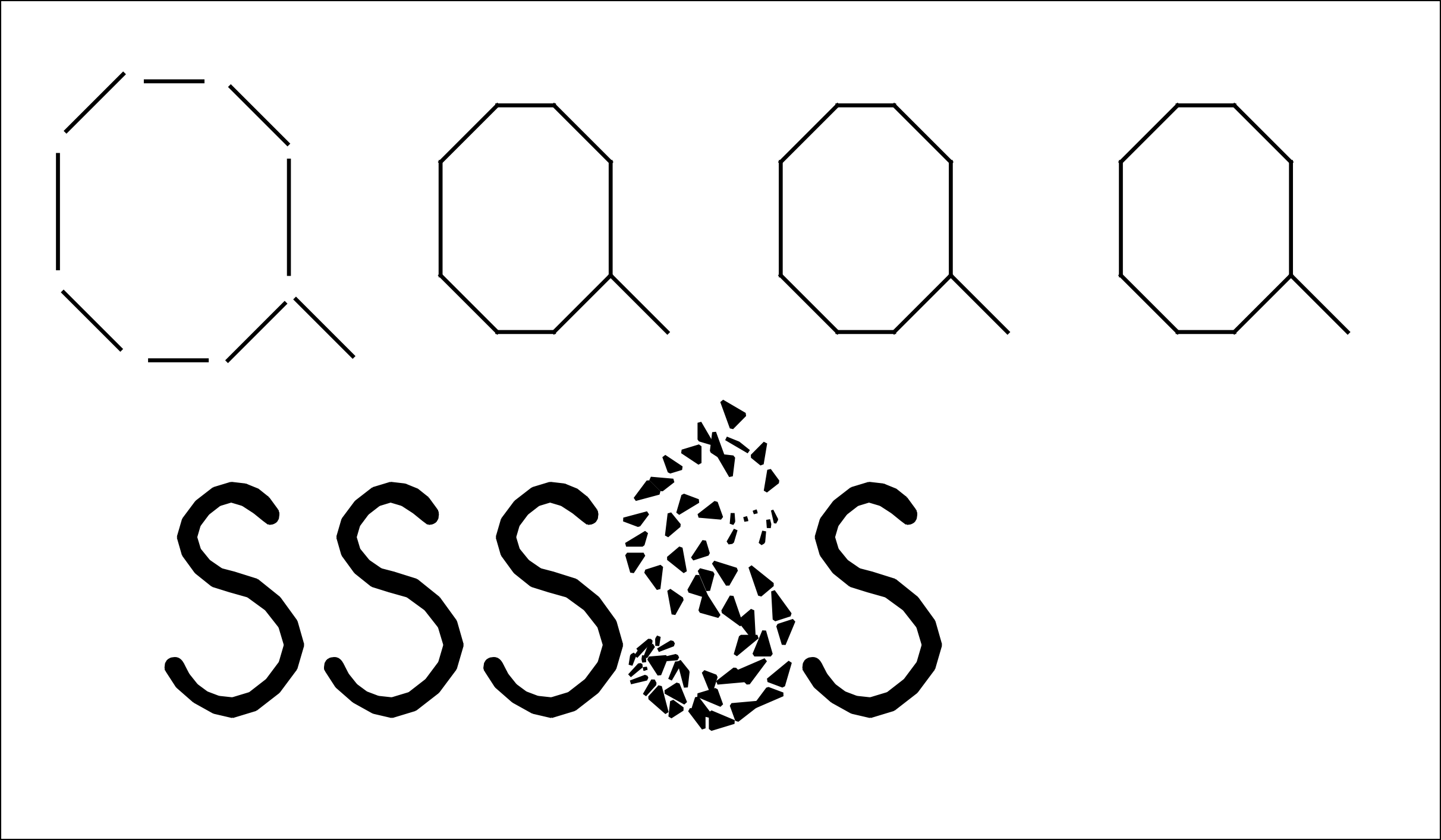

Now, I have uploaded a small and simple example of what I am talking about, text created and "printed to a SVG file" in Draftsight and then opened in Inkscape.
The linear "a`s", that look awful, are made up of several separate line segments. That`s OK, it doesn`t impact performance at all. The issue is when the font used is not a linear one (the "s`s"), like the one I used before. As you can see the letter in Inkscape is made up from many, many different and apparently random shapes, that in many cases (specially at the edges of the letter) are even placed one in top of another. Apparently that complexity is what causes the performance troubles.

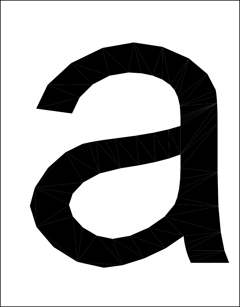

I tried to "print to PDF" some text in Draftsight and the result was very interesting. The letter came in one piece, yes, but if you look closely you can see little lines all over the letter forming the little triangles.
I opened my original SVG file today (the one with performance trouble) and, surprisingly, performance was very good. I almost did not have any problem working with the file. But the letters from Draftsight are still made up of several independent pieces.
I tried afterwards to convert some letters made in Inkscape to curves, and the resulting character was just one piece, unlike the ones from Draftsight.
I noticed that this behaviour of transforming characters to several triangle like pieces occurs in all fonts that have "width", "body", rather than the ones that are just linear. For example, Arial comes in these little triangles.
I am attaching both an example of how the letter imported through PDF looked, and an original svg file of an "a" as exported from Draftsight (I couldn't upload the svg file, this message came up "The upload was rejected because the uploaded file was identified as a possible attack vector." (?) )
