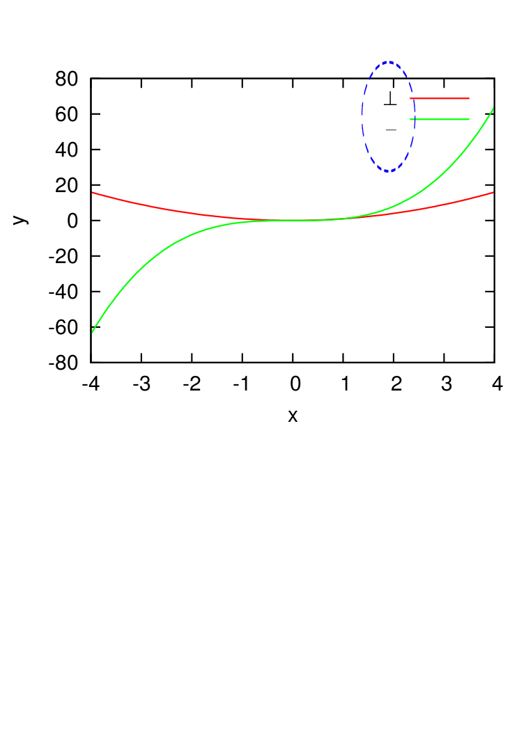

I want to import an eps file with some Arabic characters. This is a scientific figure generated by Gnuplot. It should look like this (please pay attention to the blue dashed line ellipse which contains the Arabic characters):
However, when imported in Inkscape, it looks like this:
Could somebody tell me how to make the Arabic characters display correctly, please?

I will answer it myself. We can transform the file format from eps to svg.
ps2pdf 00.eps
pdf2svg 00.pdf 00.svg
Now we can import 00.svg and we will get exactly what we want. The imported figure will be very clear.

There aren't arabic but greek (alpha and beta)... Looks like a character encoding bug... or characters that do not exist in the font used. You can edit the SVG saved by Inkscape (ideally using an UTF-8 capable editor) and search for the corresponding <tspan>. You can replace the characters by pasting them from somewhere else or by using their Unicode escapes: α and β
